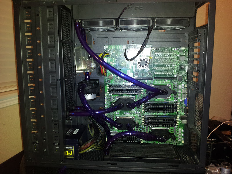

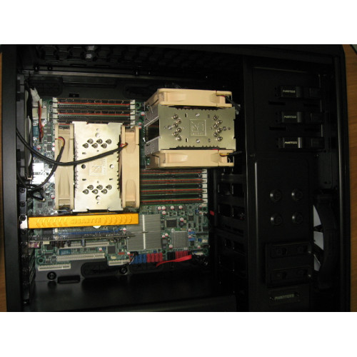

Offtopic but not too much: anyone can recognize which case is this and which liquid coolers are those?
I never see a stuff like this! This board is less opensource than kgpe-d16, but is quad-processor :open_mouth:
Is supported by coreboot 15h project

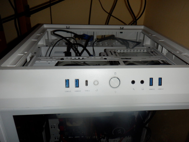

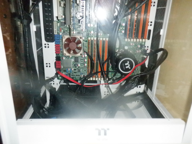

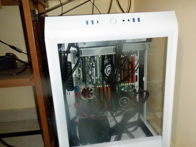

New upgrade for my kgpe-d16.
New aio Thermaltake from Amazon Thermaltake Water 3.0 120 ARGB Sync AIO Liquid Cooling Kit : Amazon.it: Computers
there also some pieces available, but they send it in 7 months, I have buy the latest available :stuck_out_tongue:
Why? Because old zalman 310 has some strange “brown piece” in the radiator and the smell burn my nose and lung, I have tried this one and I hope finally solve those problem, consider Zalman LQ-310 were used and this one is new. I have recycle the modded Zalman-310 attach.
Next upgrades
  • A 16mb flash memory bios (soon)
  • More ram
  • Asus Pike to use sata-3 ports (the internal controller is sata-2!)

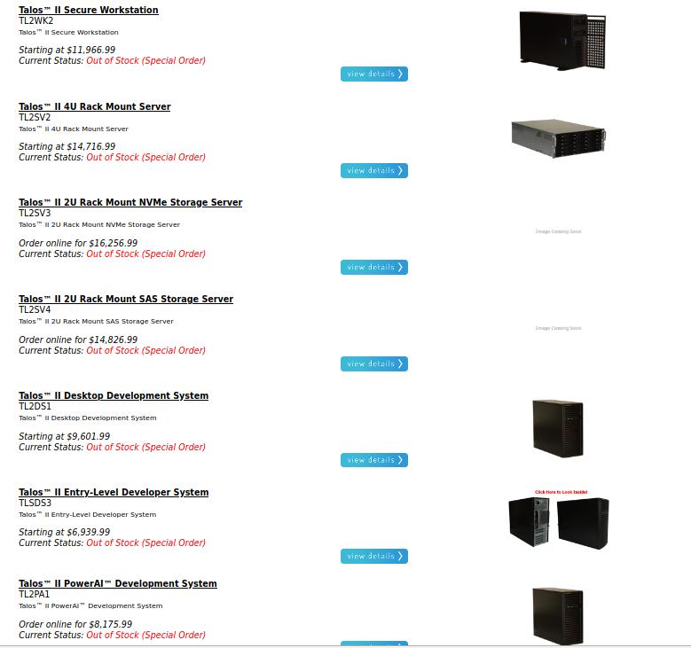

Actually the only way to get a really 100% Open hw is use Thalos workstation, only two problems
  • expensive
  • as I understand all thalos products are out of stock and I never see it on Ebay :expressionless:

One of the FSF associate members has talked to them. They confirmed that they are still selling the systems. So, “Out of stock” should not be read literally. As far as I understand, they do not sell the CPUs separately, for example.
Used devices are sometimes offered by other buyers on their community forum.
I also saw some components, such as RAM, being offered on the FSF’s forum for associate members. Obviously, there are users there.
One could also try asking on IRC or elsewhere.
I don’t know whether this is more or less reliable than buying over eBay. I have never tried myself.
However, I imagine that the owners will now be less willing to part with their Talos and Blackbird systems considering that POWER 9 is now EoL and it will be more difficult to get in the future.
I said was out of stock because in their shop I see
Yes, that is what I was reffering to. They still sell those, they just assemble them as requested. And they do not sell CPUs separately from the motherboards, for example. The heatsinks may be of a different design, and so on.
