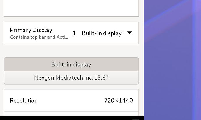

Just plugged everything up again to test the NexDock2025 and it’s just as I said in this post. The L5 will recognize the external display and report it’s make and resolution (Nextgen Mediatec) but the dock screen remains a blank white screen. The keyboard and trackpad seem to have not affect on the L5 screen while in the Settings app looking at the displays settings. So, does Crimson have newer drivers or something to help?

the L5 “thinks” the screen is there when i do a screenshot. but the dock screen never changes.

I do have another display that I tried with no success. I have tried multiple cables in every possible orientation. The nexdock splash screen does show and the on screen menu works. But on my L5USA it does not pick up the trackpad or keyboard either. Is there anything I can check in my phones software to see if I have the latest driver or something for the USB-C DP stuff?
If no displays work, then it is most likely a problem with the USB-C hardware in the Librem 5. Unfortunately I think this is most likely hardware if both DisplayPort and USB 2.0 are affected.
@dos do you know of anything in software worth troubleshooting to address DisplayPort and USB 2.0 not working?
It is pretty straightforward to replace the USB-C board though, and it’s separate from the mainboard, so if you want to go that route I’d suggest opening a support ticket. I don’t think it’s still under warranty since it’s an L5 USA and those have all aged out of warranty by now IIRC, but we can provide parts or service out-of-warranty if you want to go that route.
