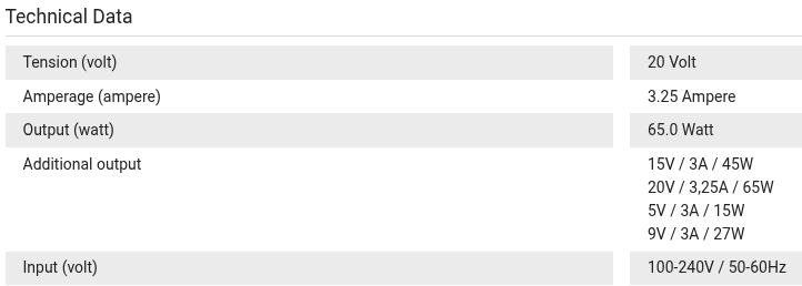

According to this web site listing for the Dell HA65NM190 (model number of 65W USB-C power adapter) the following voltages are supported
That provides the additional confidence that they will do the right thing - negotiate 5V and 3A max. If connecting to that charger, you should use the above cat command to confirm.
