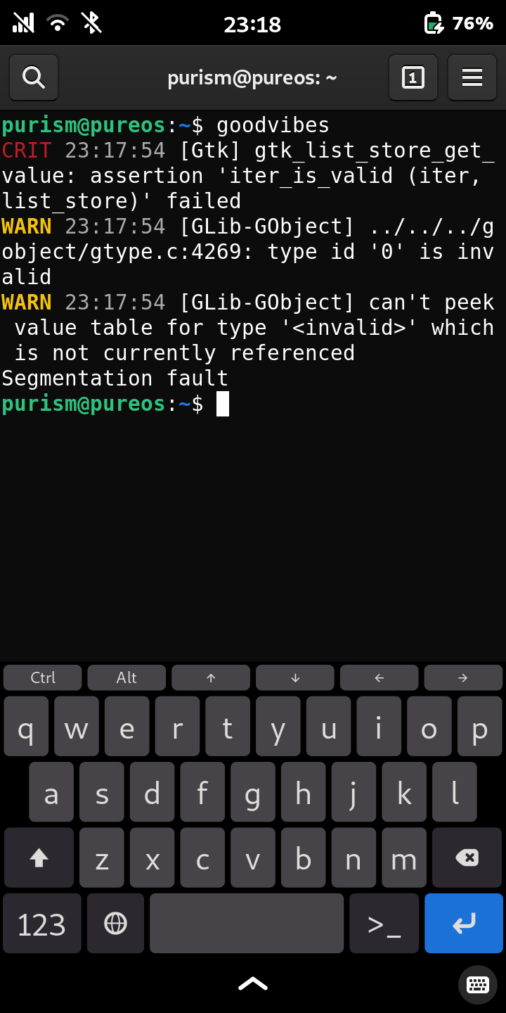

On a whim, I tried launching goodvibes from a Terminal, which worked. I then provoked a crash by tapping a station and the result is attached, which might be helpful for the developer or packager.
Which version of the application are you running?
This appears to be issue: Crash when playing station from touchscreen devices (Debian 11, version 0.6.2-1) which was fixed in v0.7.2.
I’m guessing you are installing from PureOS Byzantium repos? PureOS Byzantium pacakges v0.6.2.
Try running version v0.7.2 or higher.

That’s the same error I posted. :wink:
