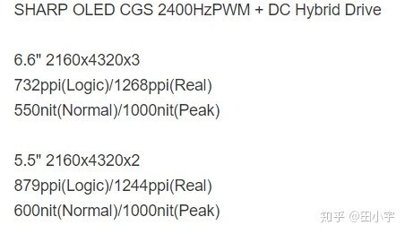

Even though looking forward, I wish (or dream) there is an option for a custom 18:9 (2:1) display (by paying extra cost) like this one:
CGS technology and its low(er) power consumption, surrounding circuits and functional elements built into the LCD panel, etc. is described here.
And, as Purism is already setting very respectable standard I may be pleased with whatever display available within the production deadline to make L5(+) Vivante GC7000Lite GPU allive (and happy).

I’ll try reading it later with machine translation, but could someone translate these documents?
I am sorry that i cannot help for real. Machine translation (although not precise and sometimes confusing) may provide just enough of touch to what 田小宇 wanted to share with (all of) us (I believe so). I hope you’ll find someone to help you with this one (because it matters).
No promises but I’ll ask around.
However I found this (from possibly the same author of those documents?)
