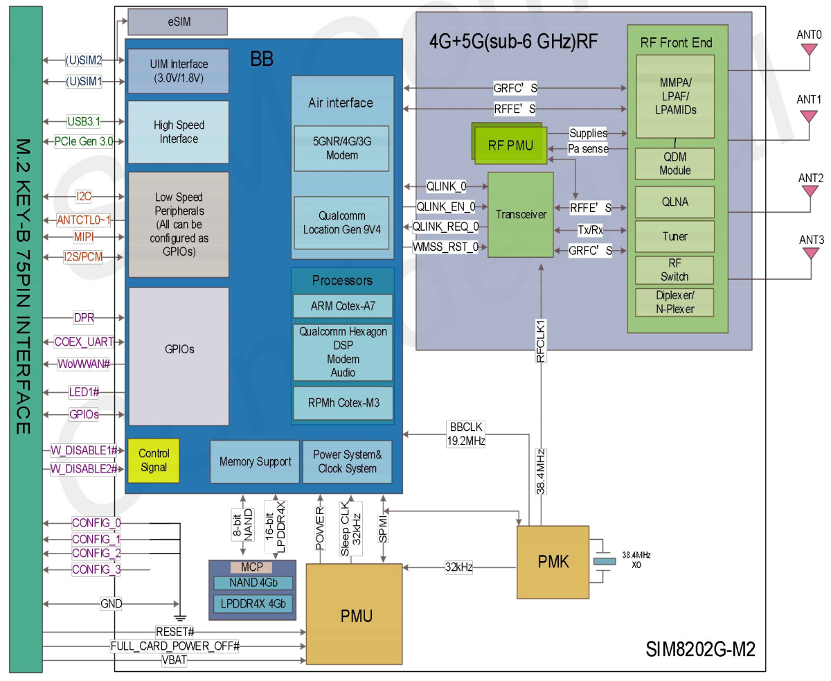

I interested to know how much RAM and ROM is it this 5G Module.
I really like (not just from security or openness perspectives but as a customer) how there is so much info available (unlike with BM818), like this block diagram in the hardware manual that mentions (down left) 4Gb of memory - which seems appropriate for message storing, 4k/8k video decoding, USB3.1, VR (etc. other things the processor was meant to be used) and running an OS (linux btw.). There is a reason why modems should be separated.
Interesting thing is that little eSIM box on top left corner… (no info on it, may not be implemented?)
Btw. following this rabbit hole, I checked some of the components, and it’s using Qualcomm x55 5G modem processor (a lot of specs here - of course, not all of them are utilized, for example there’s no mmWave components). Other components: DSP (a bit older presentation of the innards - the product line apparently later became NPU capable, kinda proving that AI is just signal calculations) and the SoC that the X55 is likely part of seems to be Snapdragon 855 or 865 (since the 8202g came out in 2020, which puts it among some interesting phones associated with that SoC, if someone wants to compare specs [BM818 uses Qualcomm’s MDM9207 IoT modem chip, which is just listed in the “others”, which says something]).

Found the hardware reference to that eSIM (the string wasn’t what I expected):
"SIM8202G-M2 supports two (U)SIM cards but single standby. The (U)SIM2 can use e-(U)SIM card in the module or external (U)SIM card, the size is 2mm x 2mm x 1mm of the e-(U)SIM in the module. Both (U)SIM1 and (U)SIM2 are dual-voltage 1.8V or 3.0V.
NOTE: Customers choose the e-(U)SIM products according to the above size, SIMCom will provide the e-(U)SIM assemble into the module."[sic]
Also: “The SIM card hot swap function needs to be enabled by AT. Please refer to the SIM8200 Series_AT Command Manual for the setting of the detection level of (U)SIM_DET pin.” - I wonder if this can be implemented in L5 (or if there are non-modem related reasons)?
