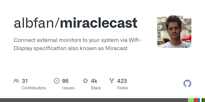

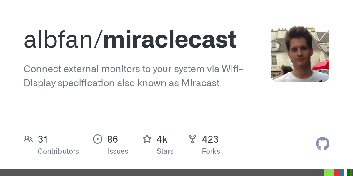

I can’t say anything about the compatibility to the Nexdock Wireless but beside the older project ‘MiracleCast’ there is a new project implementing wireless screen cast: gnome-network-displays. I guess in case someone give it a try it would be good to present the results in a dedicated thread.
