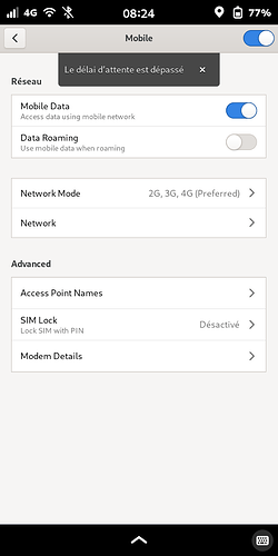

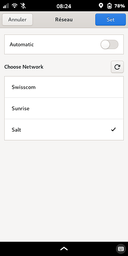

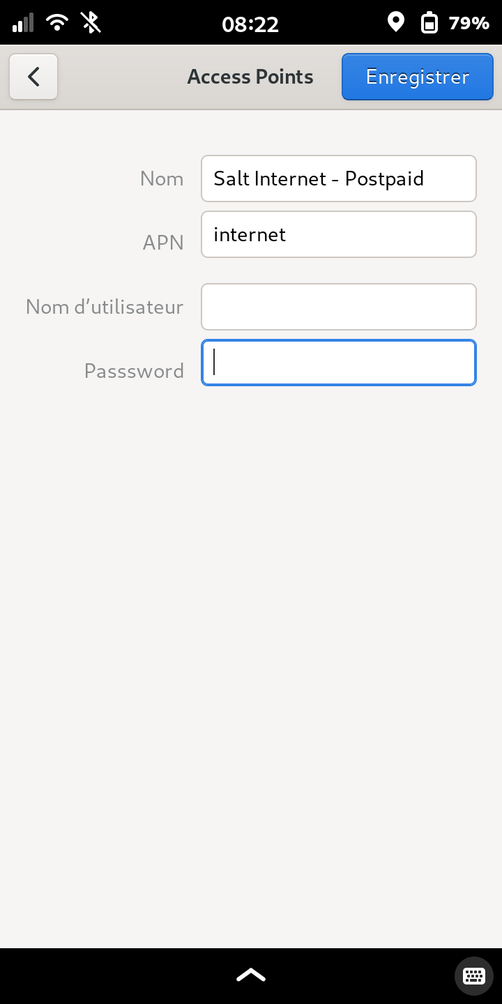

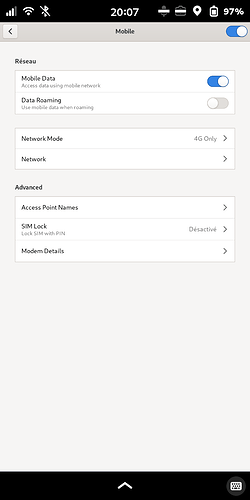

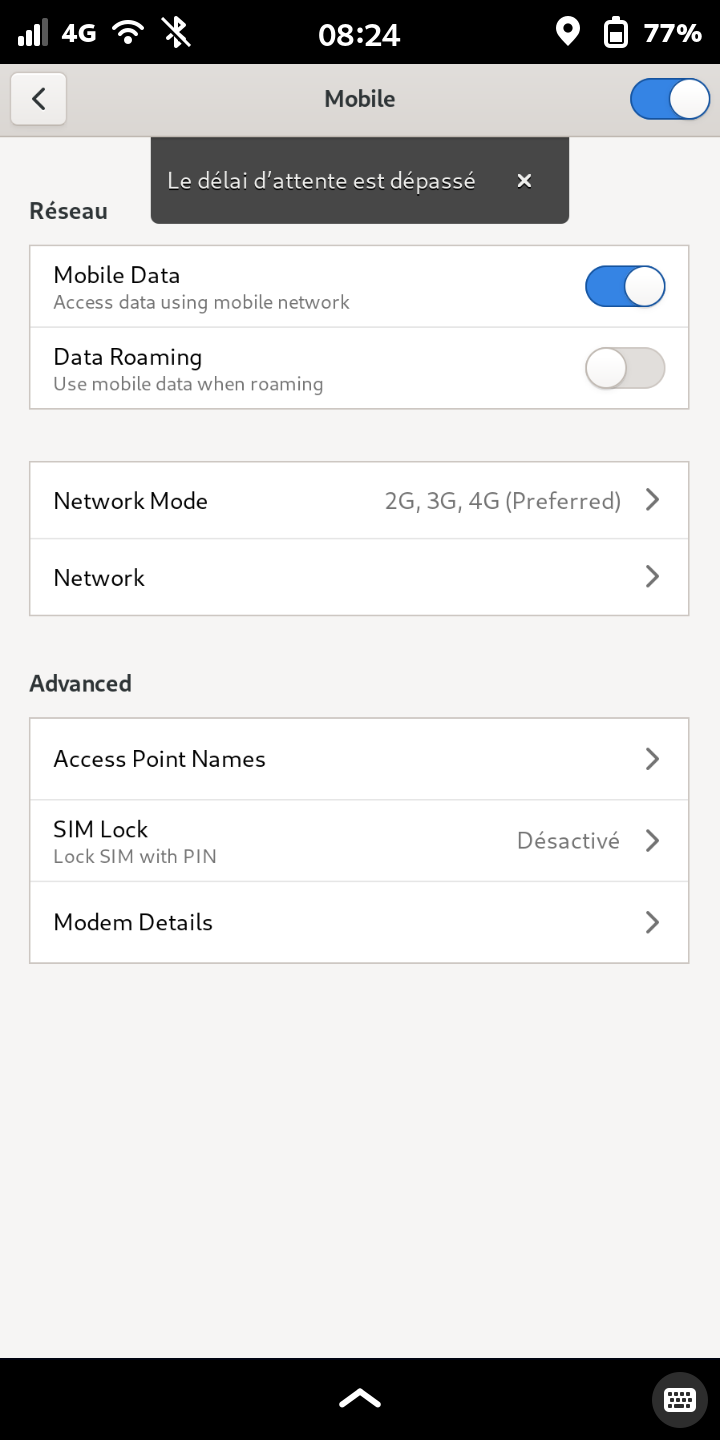

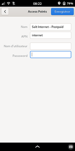

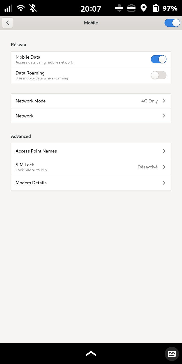

[SOLVED] HELP, I replaced my phone's USB board and now the modem no longer works
Right. It seems the modem is recognized but not networks which would indicate that there may be something with the cables (either not connected right or broken). For networks and connection strengths I’d use the relevant AT commands via terminal to get the more technical info (instead of what the modem prefers, the info of what the modem gets), see: Librem 5, Cellular Network Testing - #8 by irvinewade
