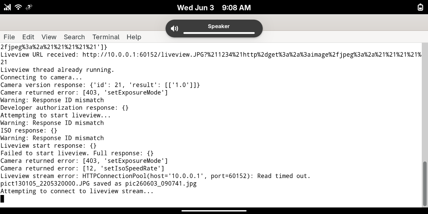

Ok, so I checked a few things already and didn’t find any reason. I’m probably going to have to guess randomly some things. The L5 side dependencies are unlikely culprits (at this point anyway).
The first on my list is that your QX is defaulting to ‘preview’. The script doesn’t specifically request normal image as I’ve always thought that’s the default, but it’s possible that your QX is going with the smaller instead. I’ll have to see how to come up with a check, where that goes.
The ISO values are populated a few seconds after connecting to the camera and may fail. Restarting view (if I remember right) should try to reset those as well (in a few seconds delay).
Thank you for any and all time you spend on this. At this time, the fact that the ISO values are not populating does not seem very important as I believe the camera defaults to auto?

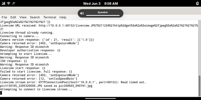

For what it is worth, here is the error message that I receive when the camera connects and when I take a photo:
I am not sure if this helps you or not.

Did you look for and change the AUTH_CONST_STRING? The error message references Developer authorization response and ID mismatch, which could be connected to that. The one ID-string in the script is just an example/placeholder and each camera has individual one that you need to access, as described on the top of the script. The camera should work partly without it, if I recall, and some features do not. I was never quite sure if and how that worked but it could be the culprit behind both, ISO and getting full size images (just another guess).
[Edit to add: Nah, scratch that idea. I tried to corrupt the string and nothing changed with my images - it all works. I’ll keep pondering…]
Bummer, it seemed hopeful. I did try that as I had not entered the correct ID into AUTH_CONST_STRING; however, it had no effect.
Do a little test: push the API-manual, script and the error logs + describe the problem to an AI and ask what could be wrong and how to fix it. If it doesn’t immediately identify it, ask how to add error messages, specific to this problem, to the script to get more clues. That’s probably more feasible than me trying to telepathically solve this.

I did all of that and, of course, the responses are voluminous and varied. Here is a summary:
Summary of Changes Needed
Error Root Cause Fix
ID Mismatch Non-thread-safe pId counter Use threading.Lock()
403 setExposureMode Calling before auth complete Remove from populateExposureControls
Timeout on liveview Short timeout value Increase to (5, 10) seconds
12 setIsoSpeedRate Setting ISO without authorization Only set after full auth
Empty responses Connection issues or timing Add better error checking
I should note that I downloaded the dependencies and ran the script on a Debian desktop computer. It worked very much the same as on my Librem 5 with nearly identical errors (for what it is worth).

I’m curious and this has led me to rediscover some ideas that are yet to be implemented, so… maybe. May take a few weeks though. I’ll get back to you. In the mean time, if you could post logs from when you initialize the the camera and including taking a photo, it might help.
