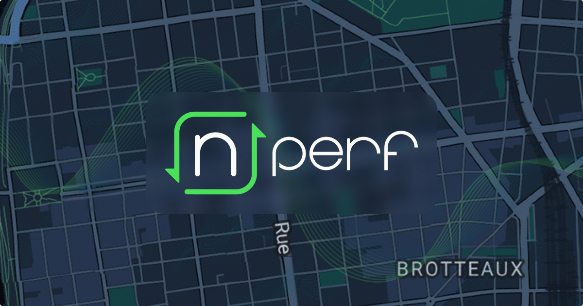

This sounds like a problem I was having with T-Mobile’s weak 3G signal where I lived, combined with my Android’s lack of VoLTE capability. Calls appeared to be trying to connect (and dropping from 4G LTE to 3G), but then sometimes not ringing or connecting at all. I had to switch to an AT&T MVNO.
How’s the 3G in your area:
Zoom way down to street level.
I don’t have 3G at my house just 4G and 2G. However, I thought VOLTE is only 4G?
I only have this issue when VOLTE is enabled(currently running with it disabled unless there’s something to test).
The map shows nothing for my house, just some line of 4G down a road about 3 miles from my house
