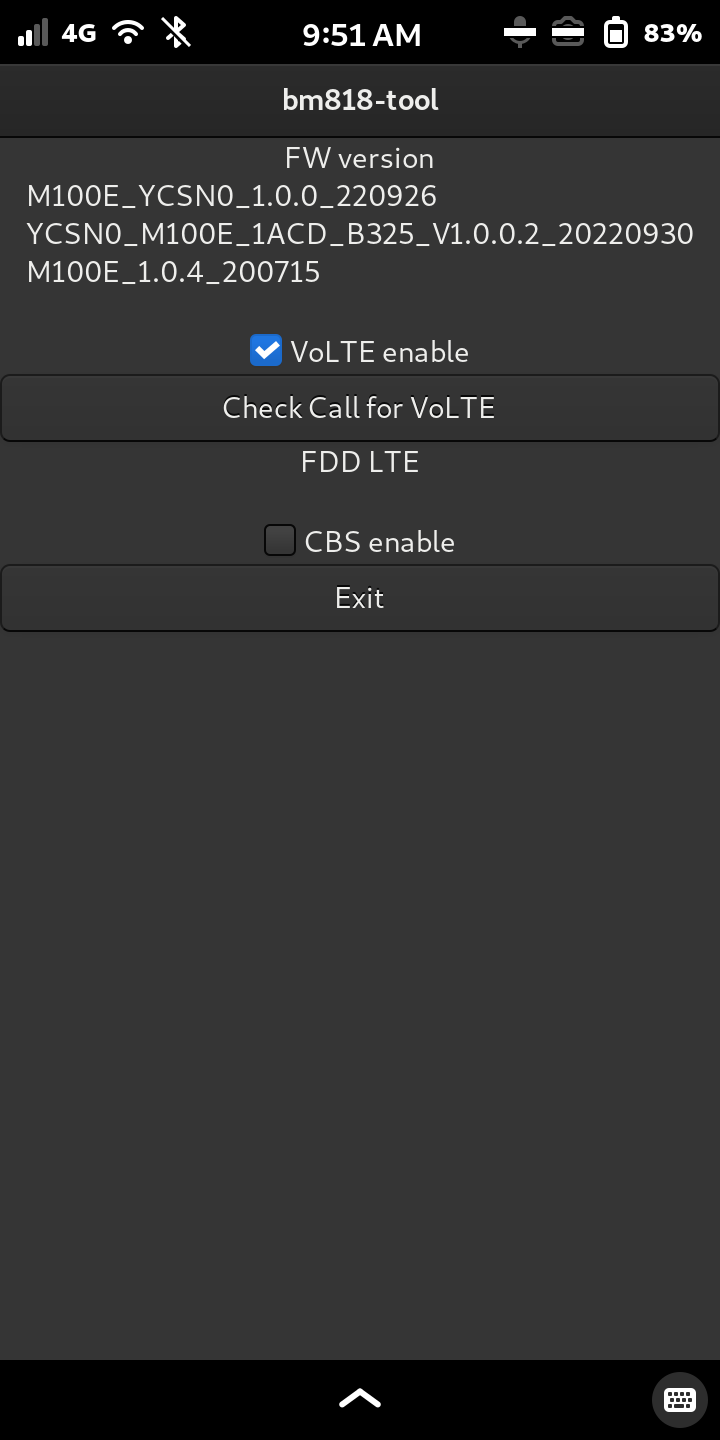

Did you check if you have the latest modem firmware?
i think it’s the latest…
It is.
