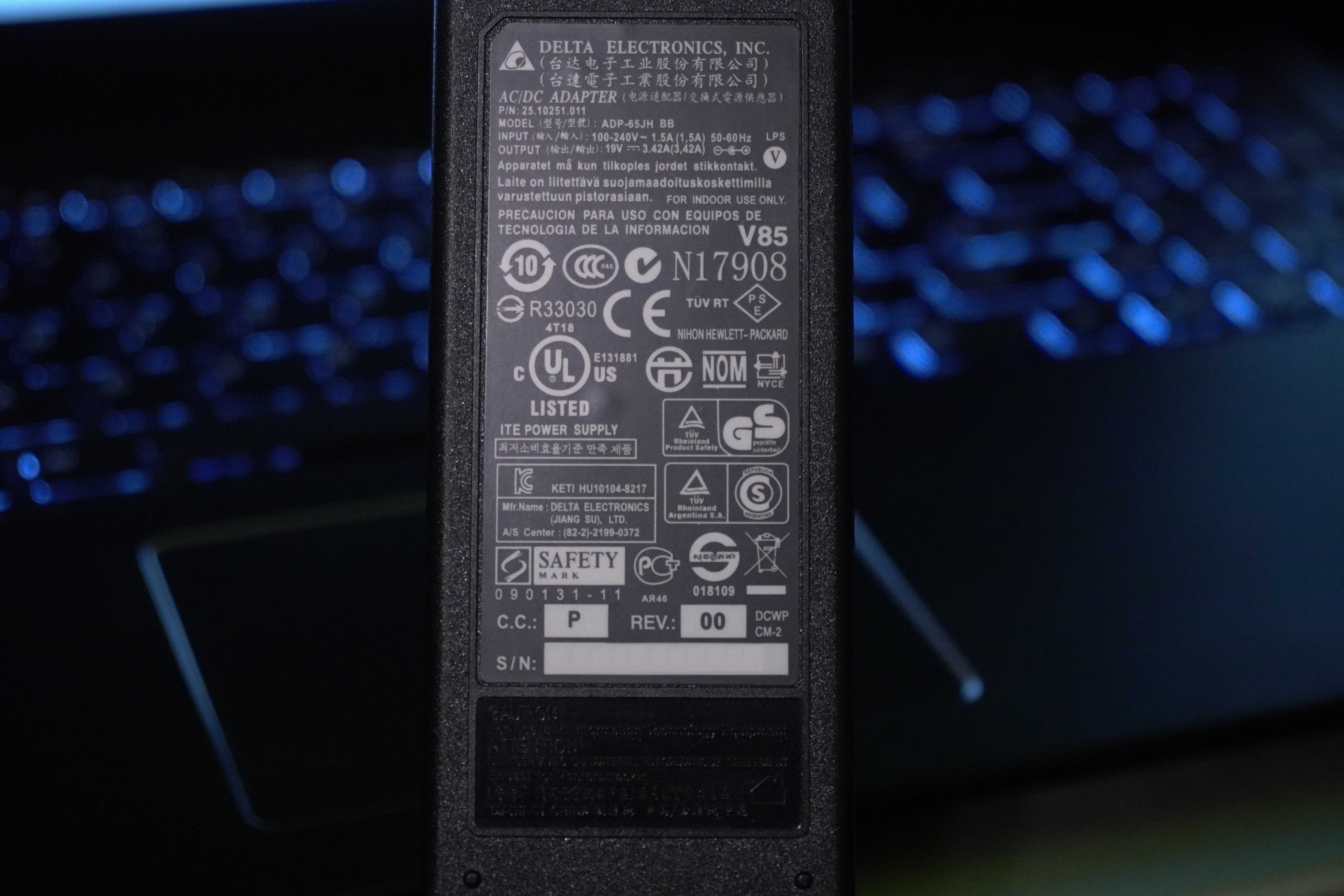

I’m pretty sure the adapter works world wide. You either just need an end adapter or the plug specific for your region. The adapter is 110 to 240v and 50 and 60Hz compatible.
A lot of (non-desktop) computers these days come with universal voltage AC/DC adapters.
If you are lucky the AC/DC adapter also has an IEC plug/socket on the AC side. Hence all you need is a power cord that has an appropriate plug on the wall side (appropriate for your location) and an appropriate socket/plug on the adapter side (appropriate for the adapter).
However this would seem to be information that is lacking. That I could find, none of the FAQ, technical specs, or documentation covers this. Crying out for textual information and/or a picture!
My Librem 13v4 came with a 110-250V /50/60Hz power adapter. That’ll probable work in most places. The power cable to the adapter has an IEC 60320 C5/C6 connection. That should solve the rest. Here’s the link to the standard
