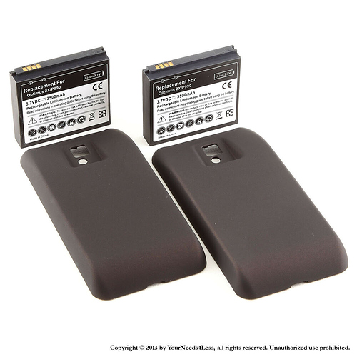

A few years ago they made third-party battery packs just like that, you didn’t even need to 3D print it yourself. Mine for the LG Optimus 2X looked like this.
Those 3500 mAh batteries were of crap quality though so the battery life was just slightly longer than the original which was a shame, would they be true 3500mAh the battery life would be phenomenal.
