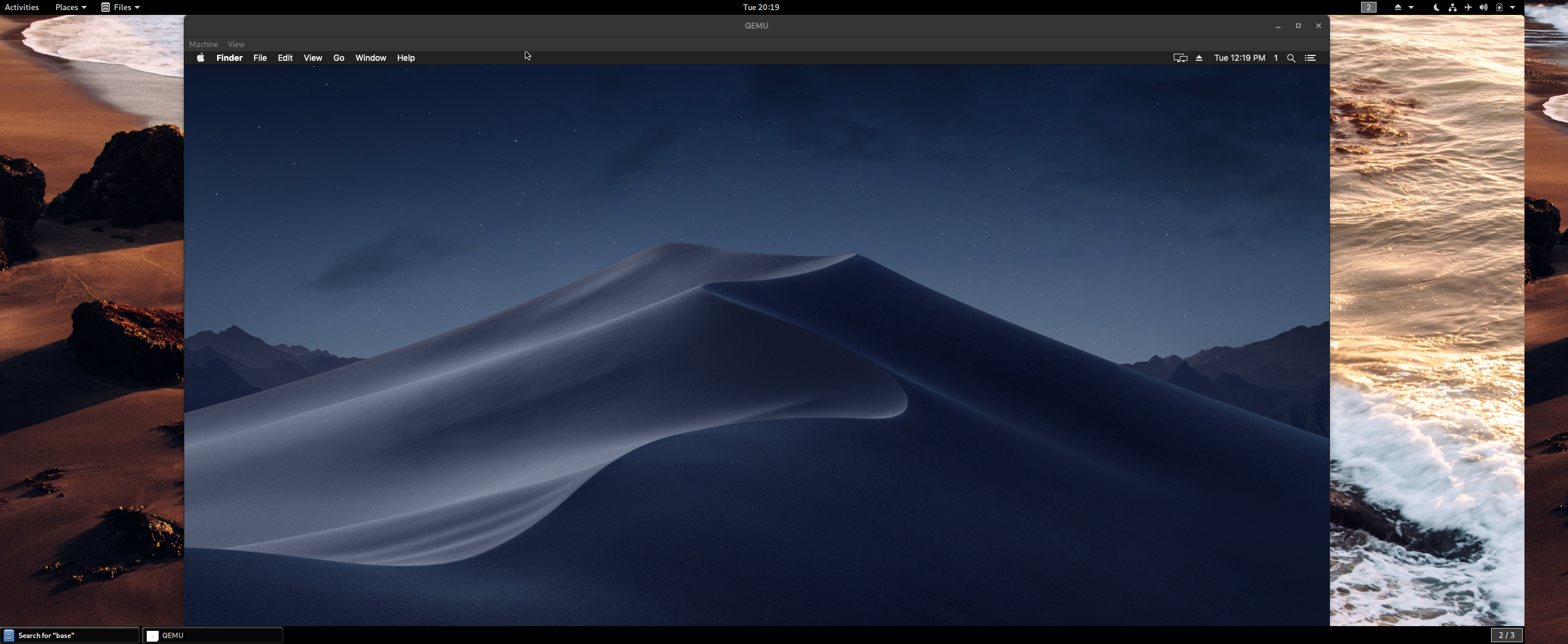

Well, after a several attempts, I finally got it working. There seemed to be a connection issue that was causing the last step to lag.
Next hurdle: getting pass-thru to work.
