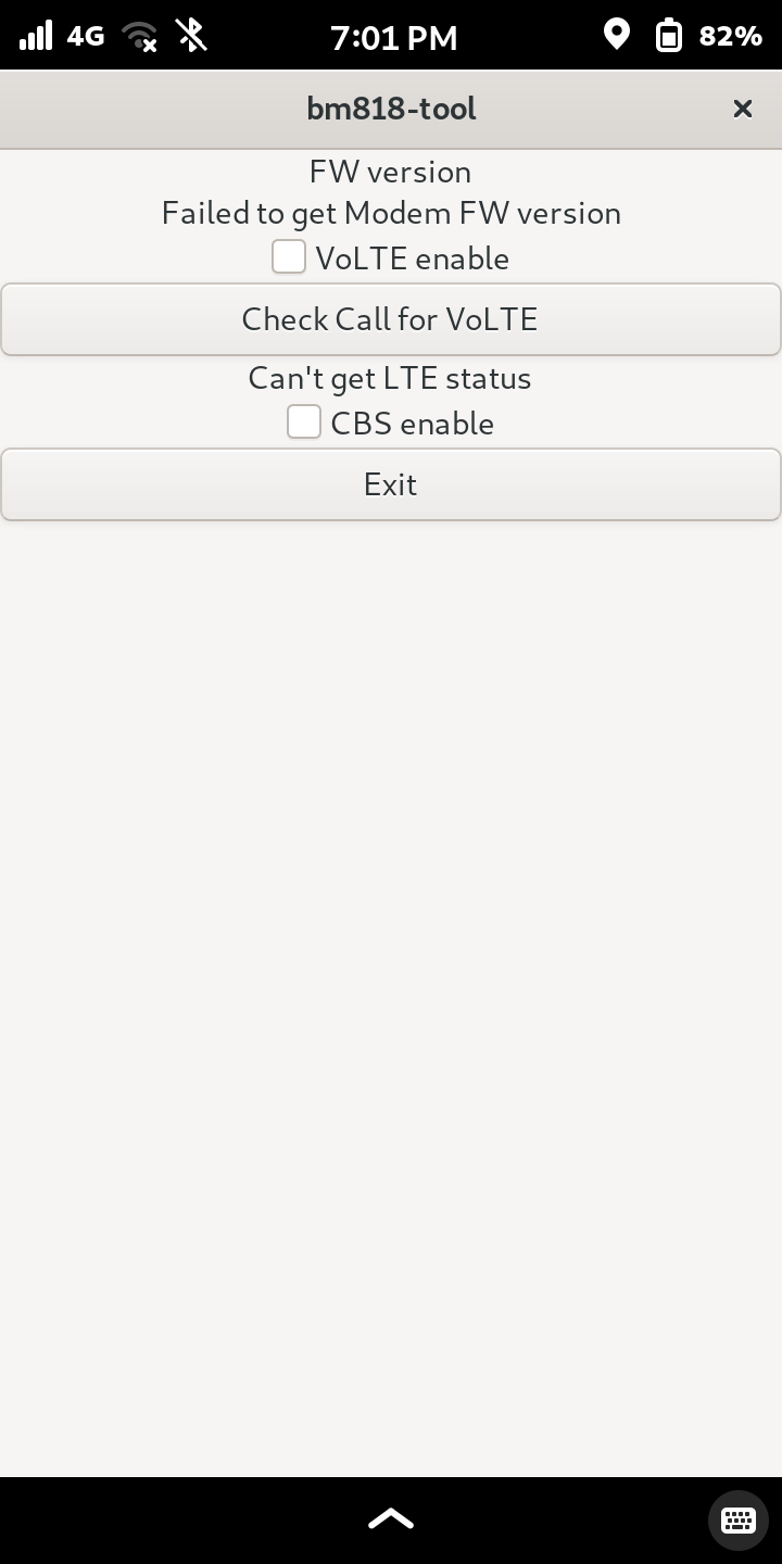

BM818-tool does not catch firmware version
I updated the package today, and it no longer pulls the Broadmobi modem details after entering the root password (the old version ran as a regular user (which may be partially why this occurred)). This is not a deal-breaker since the modem’s operations and calling are not affected.

FWIW, I just let mine upgrade bm818-tools from 0.7-0pureos1 to 0.8-0pureos1 (and that was the only package that was upgraded) and I now see the same misbehaviour.
You can workaround all the authentication stuff by running the tool from the terminal, but it still doesn’t actually work. So I guess something is just broken. If you speak Python, you might try to follow
/usr/bin/bm818-tool
Apparently serial port is not found… Wierd.
Looks as if ID_MM_PORT_TYPE_AT_PPP is not getting set for any of the four ttyUSBn devices. I have exactly no idea how that gets set. So it loops through (enumerates) the devices correctly but does not find favour with any device and therefore doesn’t attempt to communicate with the device using AT commands. The problem may not be with the tool itself.

It’s because of a patch that’s present in crimson’s ModemManager package but is missing in byzantium. Update’s incoming.
May I ask what does “every time” mean? It’s pretty much a one-time use tool.
The user should not be in the dialout group. Such configuration is insecure.
modemmanager 1.18.6-1pureos5 is now in byzantium-updates.
