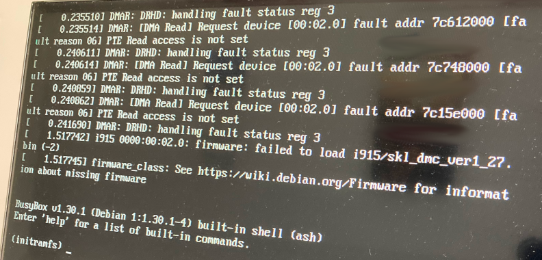

Boot Problem: Read access is not set
I was booting from an encrypted device. Unlocking the encrypted device worked, but afterwards I got this error message.
Any advice to fix that?
Thx in advance!
Booting what operating system and version on what hardware?
Librem 15v3, PureOS 10. Do not know the CoreBoot version. Can I get the CoreBoot version from within the BusyBox shell? At least I know the CoreBoot version is not the actual one.
I solved the issue myself. I changed the boot drive, and did not save the change. The boot process was working on the wrong drive.
