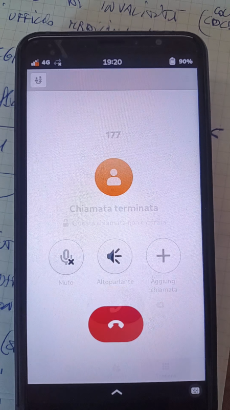

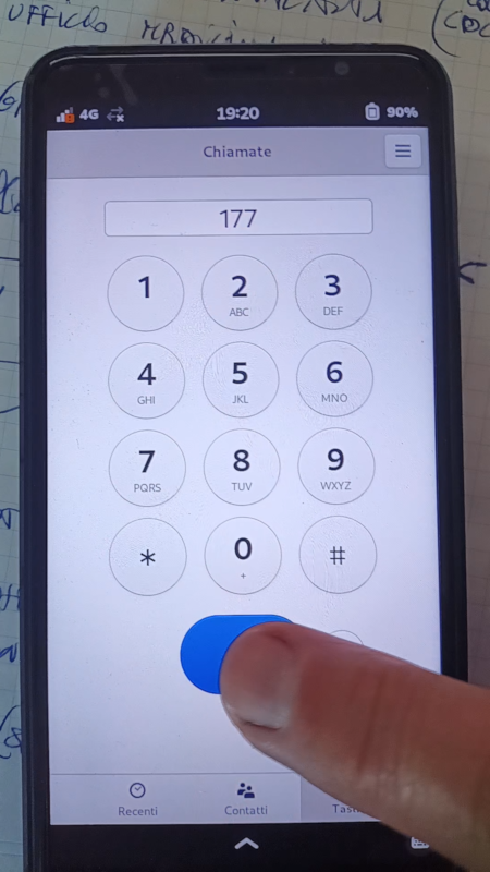

Opening it, it shows Volte enable. Tried to call and the result is the same. The call starts and is been immediately terminated.

The calls are terminated immediately. I checked it several times. The message is shown on the display (‘Chiamata Terminata’). No misunderstanding. Looking at the call history it confirms that the last out calls done was in december 2025. I didn’t use it for some months to do calls but only to update the OS through a cable connection. Then, some days ago, I realized that only in-going calls are working. SMS work in and out.
