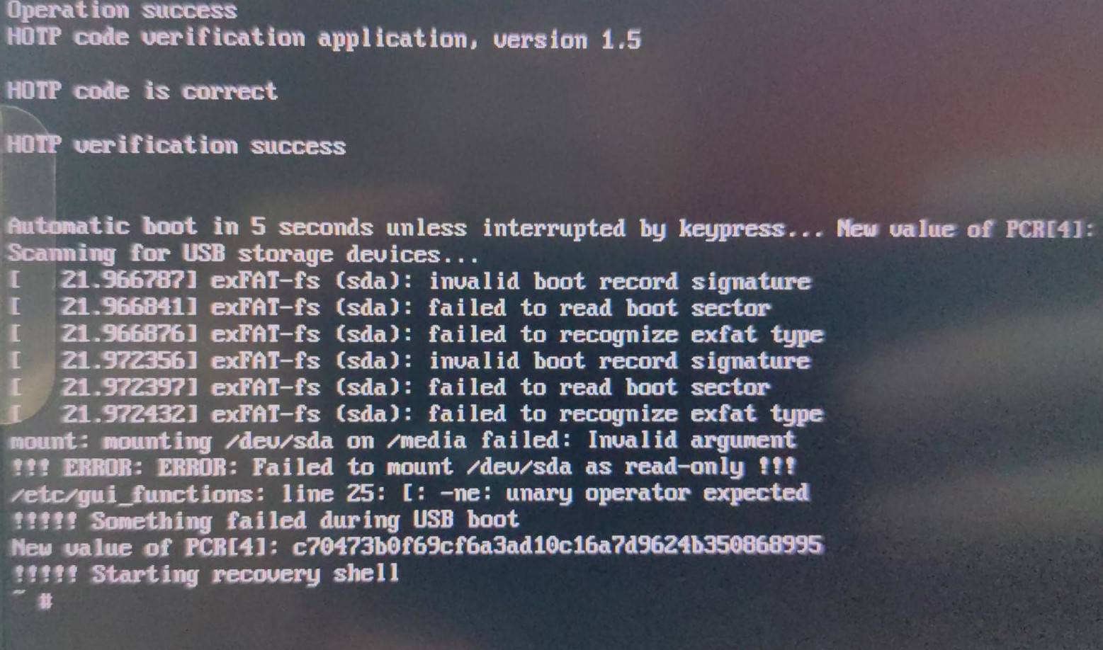

But I’m unable to boot into the .iso after burning it into a USB drive:
I burned the .iso using dd as said in the instructions.
I tried also a second time with Balena Etcher, and it game me a warning saying that the .iso lacked a boot partition so it was not bootable. When I tried to boot into it anyway I got the same error as in the picture.
It looks like your USB media is formatted as exFAT. Try reformatting it as FAT32 with the ISO. PureBoot can’t read exFAT drives yet.

I was mistaken about exFAT being a problem unless you’re using PureBoot 28 or older: https://forums.puri.sm/t/pureboot-29-release-candidate/22450
exFAT is now supported for USB media (fixes mounting some USB flash drives)
They point to the same GitLab repo with the same ISO image.

I didn’t get this warning (tested with Balena Etcher just now) - please check your ISO and re-download if needed.
Here’s the digest of the latest ISO:
$ sha256sum Librem_14_EC_Update.iso
d2ebbc8cb06244a363b192fb2bf4e31ac92d70aca882bd30ae32dd6cd8e08a9f  Librem_14_EC_Update.iso
