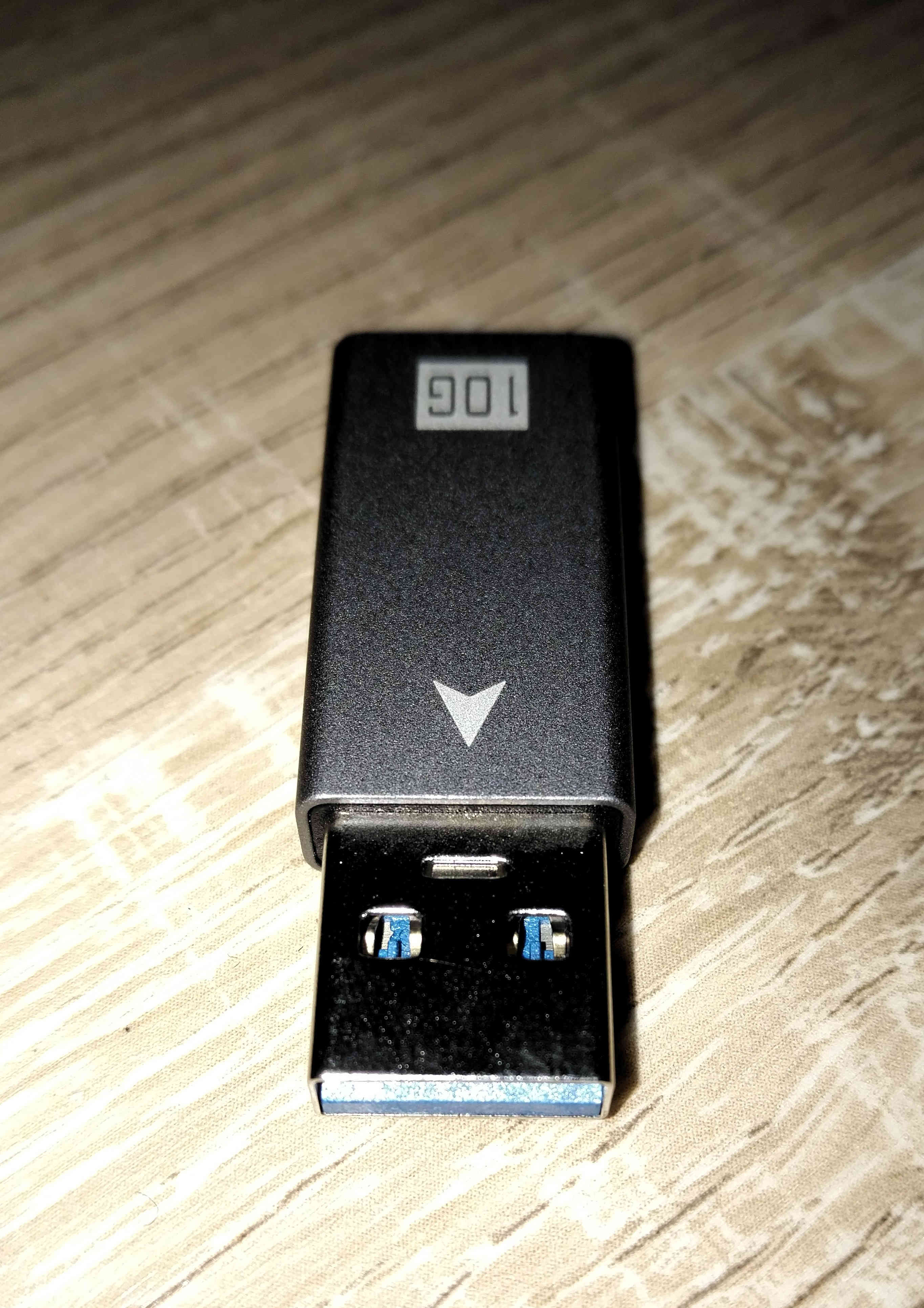

I’m using the USB-C that came with the phone over a USB-A adapter. I think the problem is somewhere else, but hard to tell where.
I’m accepting gladly your advice as another (besides above kind recommendation from @amosbatto) and as purposely better solution. And luckily I found mine, just before vacuum cleaner comes, somewhere on the floor:
