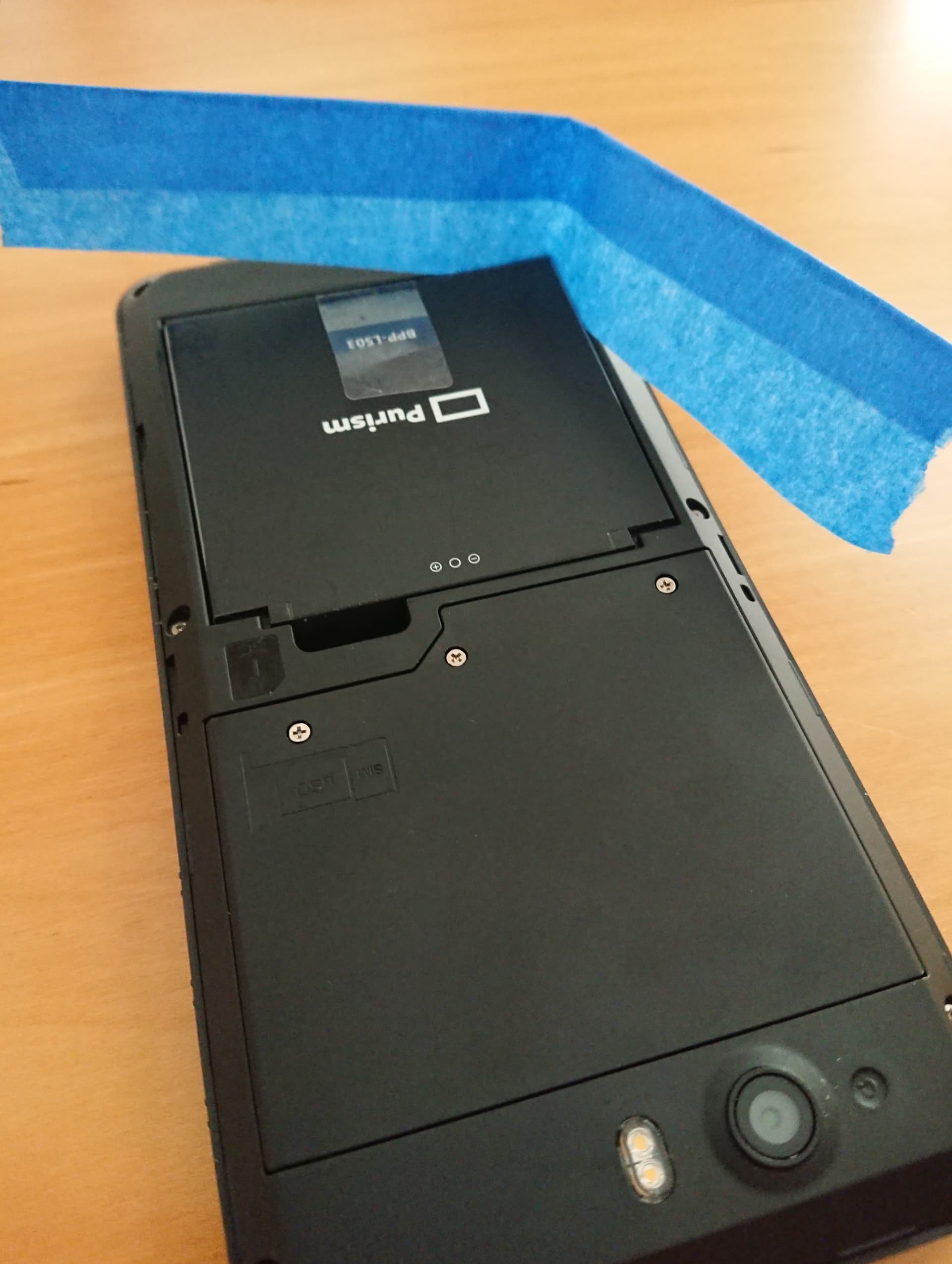

Depending on how much clearance you have around the edges of the battery, it might be possible to insert a length of sticky tape along the gap at the bottom and along a portion of the gaps at the sides (or just around a corner of the battery), and pull toward the top of the phone and upwards to lift the battery up slightly.

The tape-pull idea:
I’m having trouble imagining how that would be better than pulling harder on the Purism supplied strip.

Sit at a table with the top of the L5 braced against yourself, pull the ends of the tape toward you and up, using both hands. See if it lifts the battery enough to then grasp it or work it further up with the attached Purism strip.
