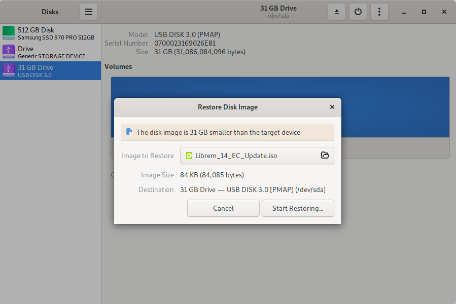

Hi, I’m following the steps below to update my Librem 14 EC firmware.
In these steps, I have to restore the ISO image to a USB device.
My USB stick is 1.7 GB, and it gives message
the disk image is 31 GB smaller than the target device
I choose Restore and it seems nothing happens.
Any advice?
thanks

Here’s a screenshot
Thanks

Your computer thinks that it’s a 31 GB USB stick. Can you clarify? A photo of the USB stick? Many (but not all) USB sticks will be marked with their capacity.
Also, did your download of the .iso file work correctly‍??? Your computer is saying that the .iso file is only 84 KB (which is surprisingly tiny - please confirm the size) but when I checked yesterday I thought it was more like 200+ MB. And that’s kind of what Gnome Disks is trying to warn you about, albeit that you are still going to get a warning anyway.
Also I am wondering what “Generic STORAGE DEVICE” (of unknown size) is. Hopefully it is not relevant here.
It looks like the latest Librem_14_EC_Update.iso is 277.00MiB in size. @chucker8, please try to re-download this file and let us know what gnome-disks reports as the image size of the file.
Purism ought to publish securely a cryptographically-secure hash of the file so that one can verify the integrity of the file after download and before doing anything with it. However the difference between 84 KB and 277 MiB ought to be clue enough not to bother with checking the hash. :wink:

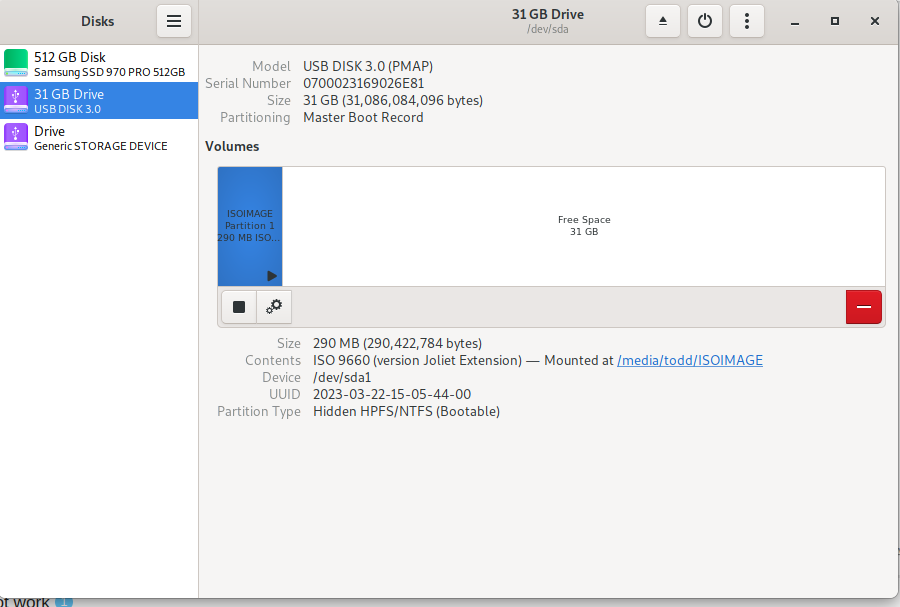

Ok, turns out I downloaded the link to the .iso image and not the image itself.
They each have the same file extension?
I was able to restore to disk.
