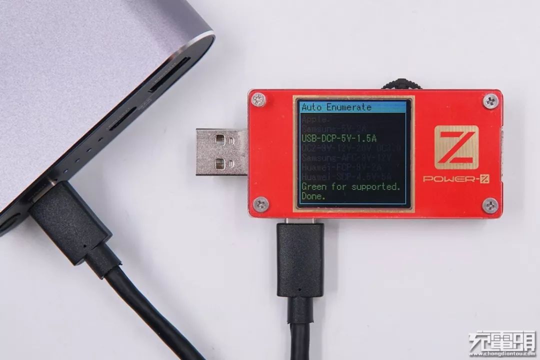

Yes, I admit that I made wrong decision toward related Internet source to link only pictures (related post links are therefore disabled now). In short, from three USB power output ports only USB-C PD1 (supporting USB-DCP charging protocol only, at 5V range) one will work as expected with the Librem 5: 拆解报告:HELPERS LAB 20000mAh 60W 双PD+QC移动电源 - 充电头网 - 我们只谈充电.

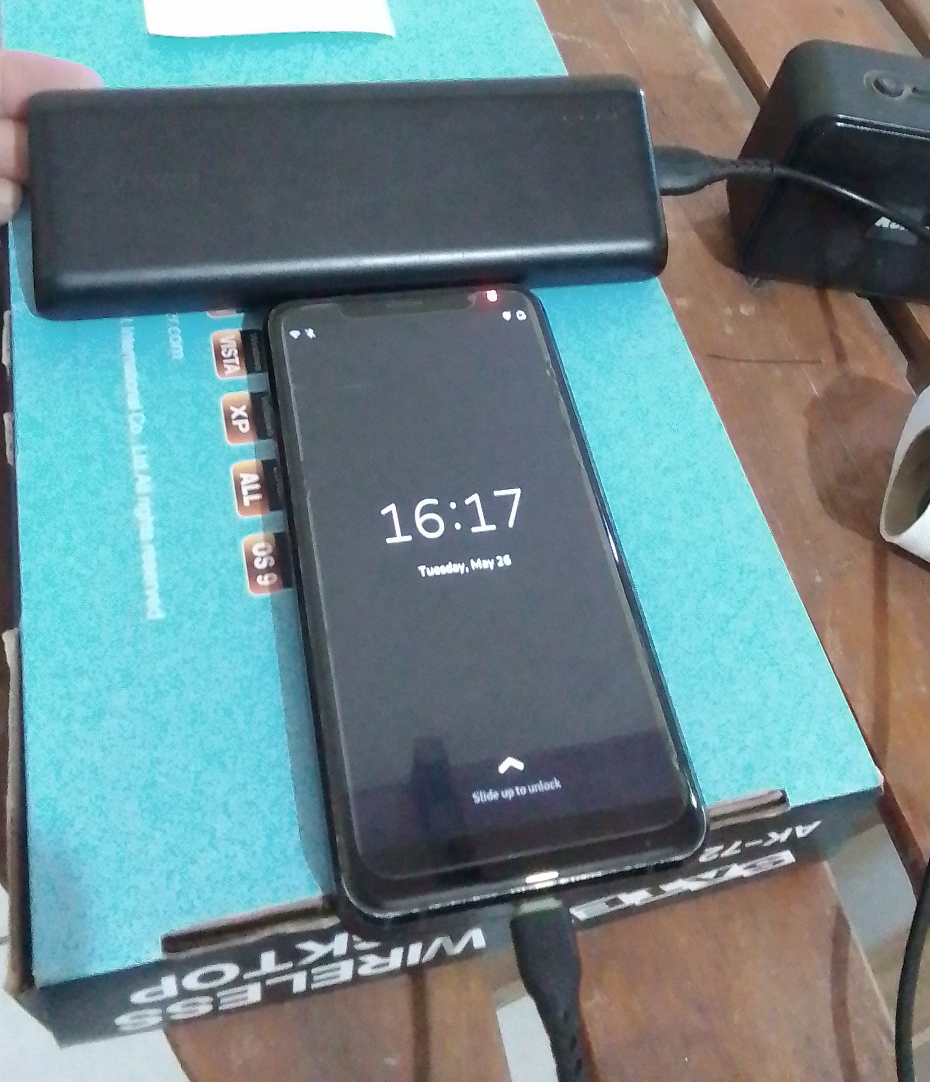

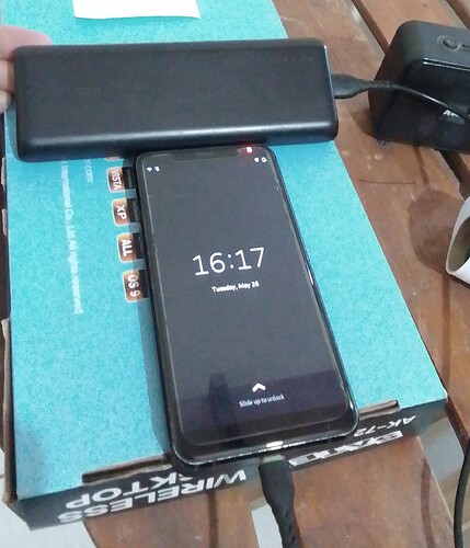

I use a 20000mAh Anker power bank to charge my Librem5

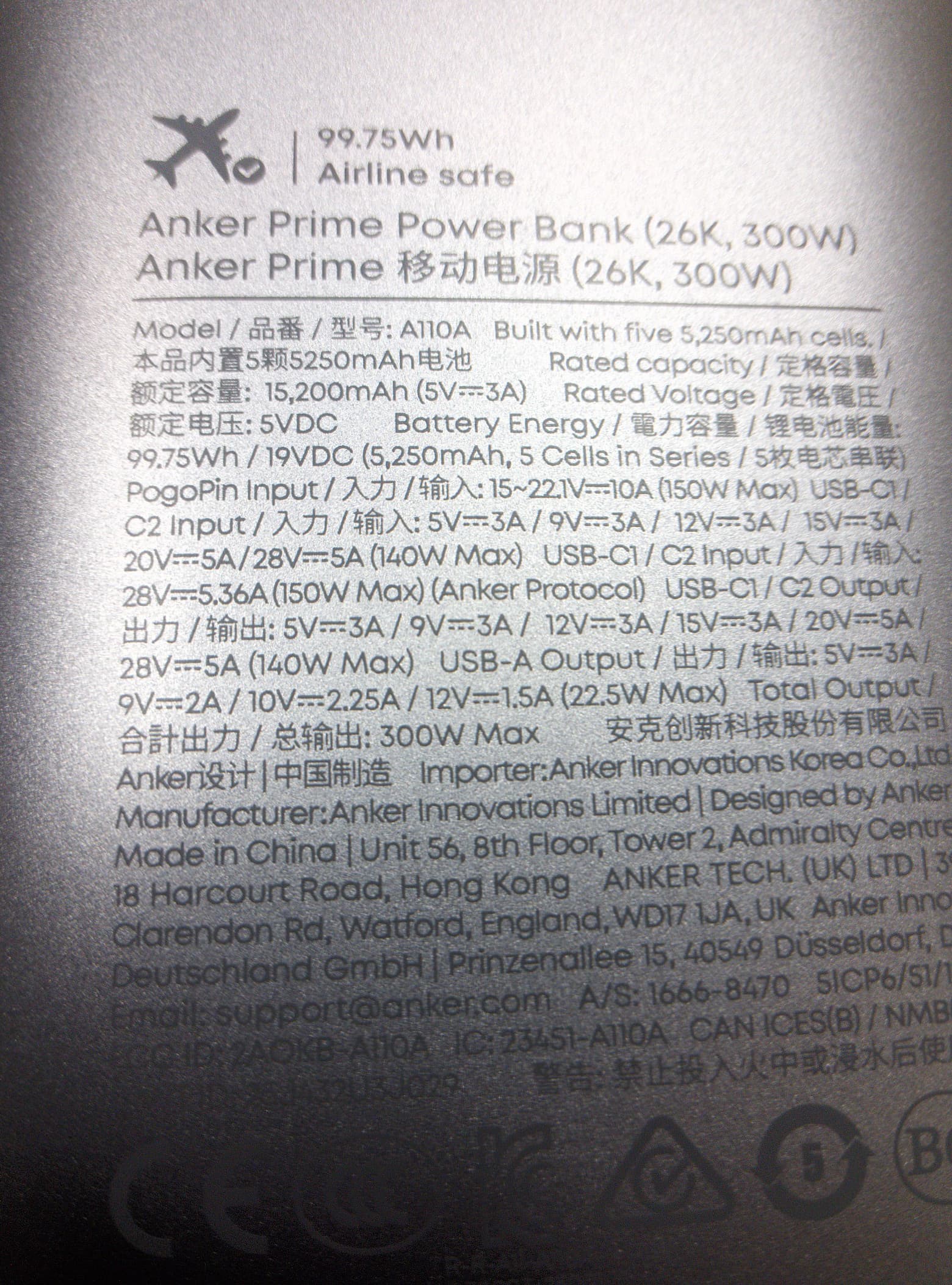

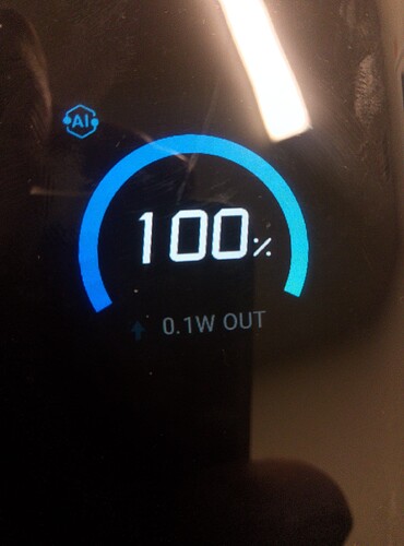

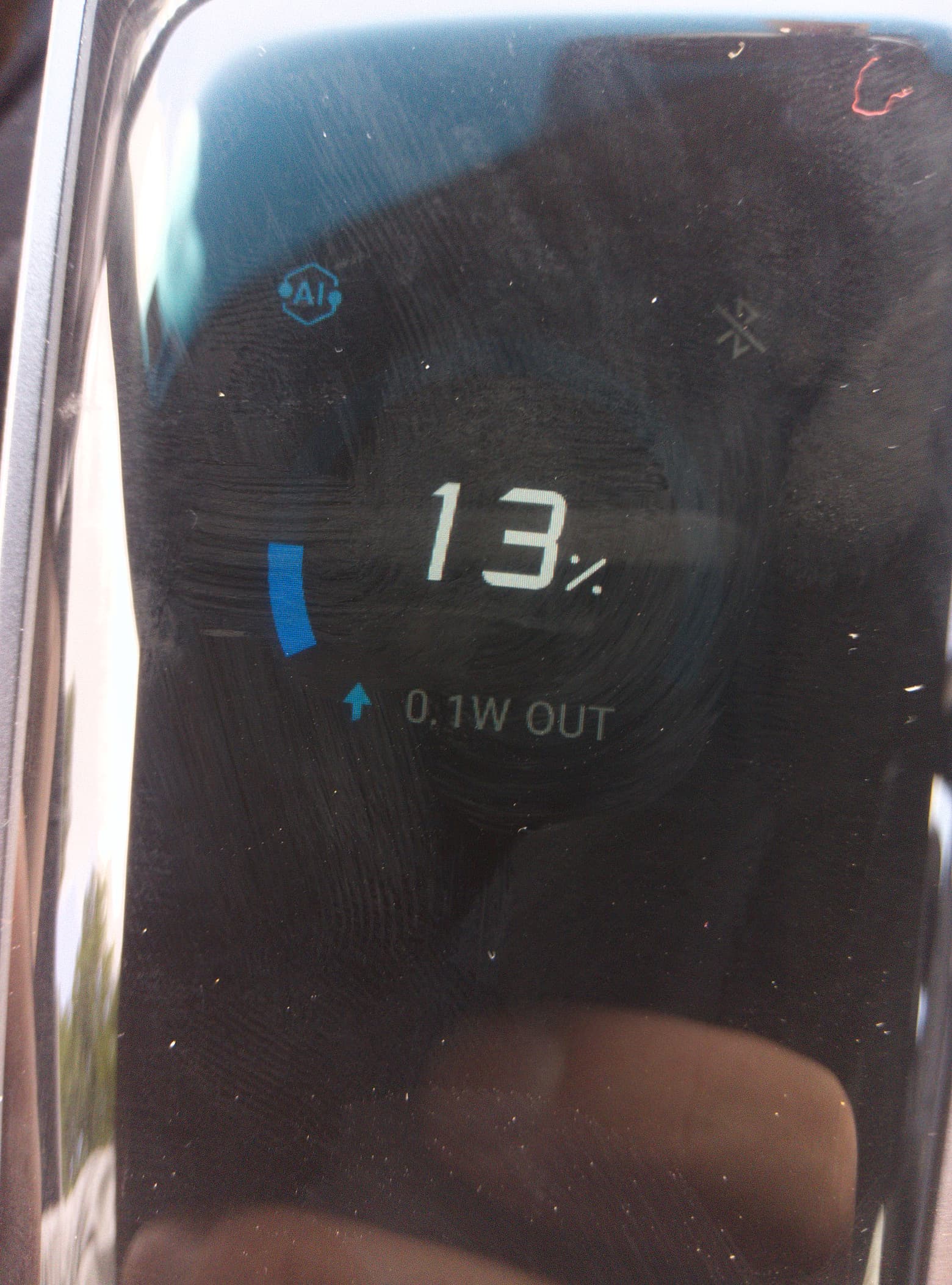

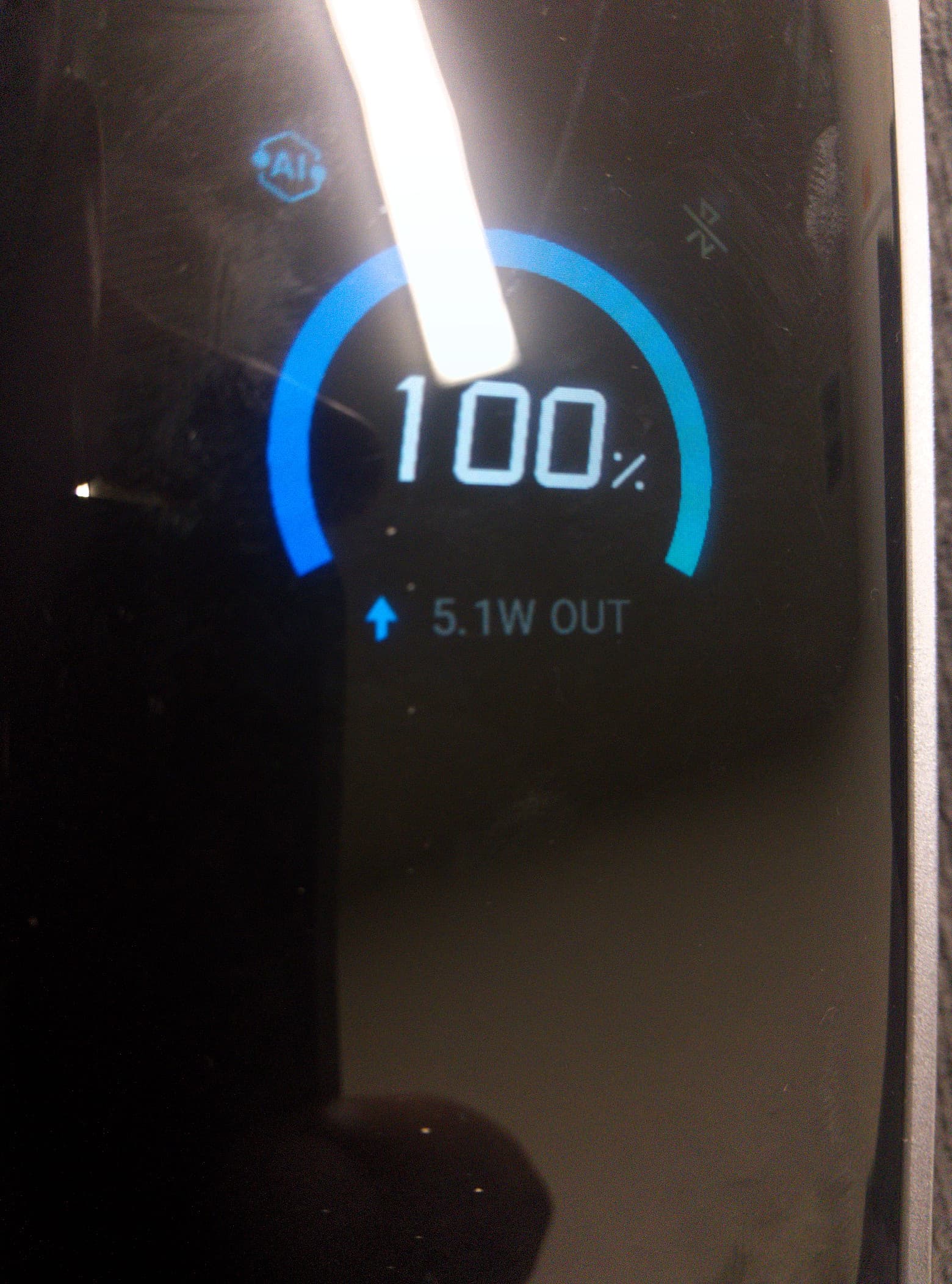

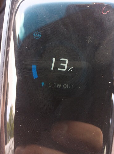

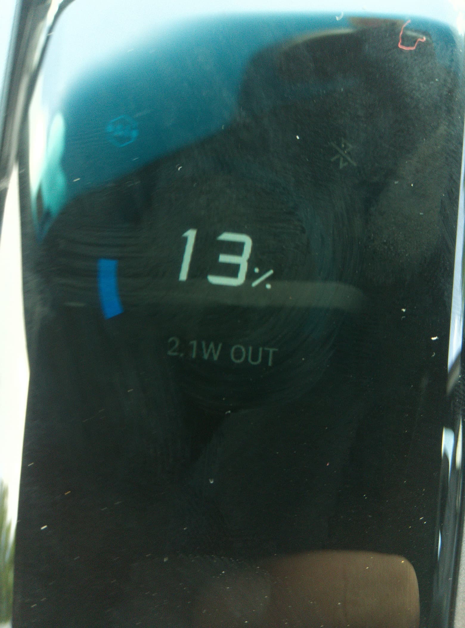

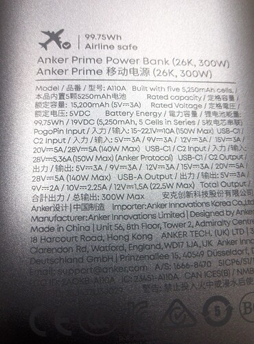

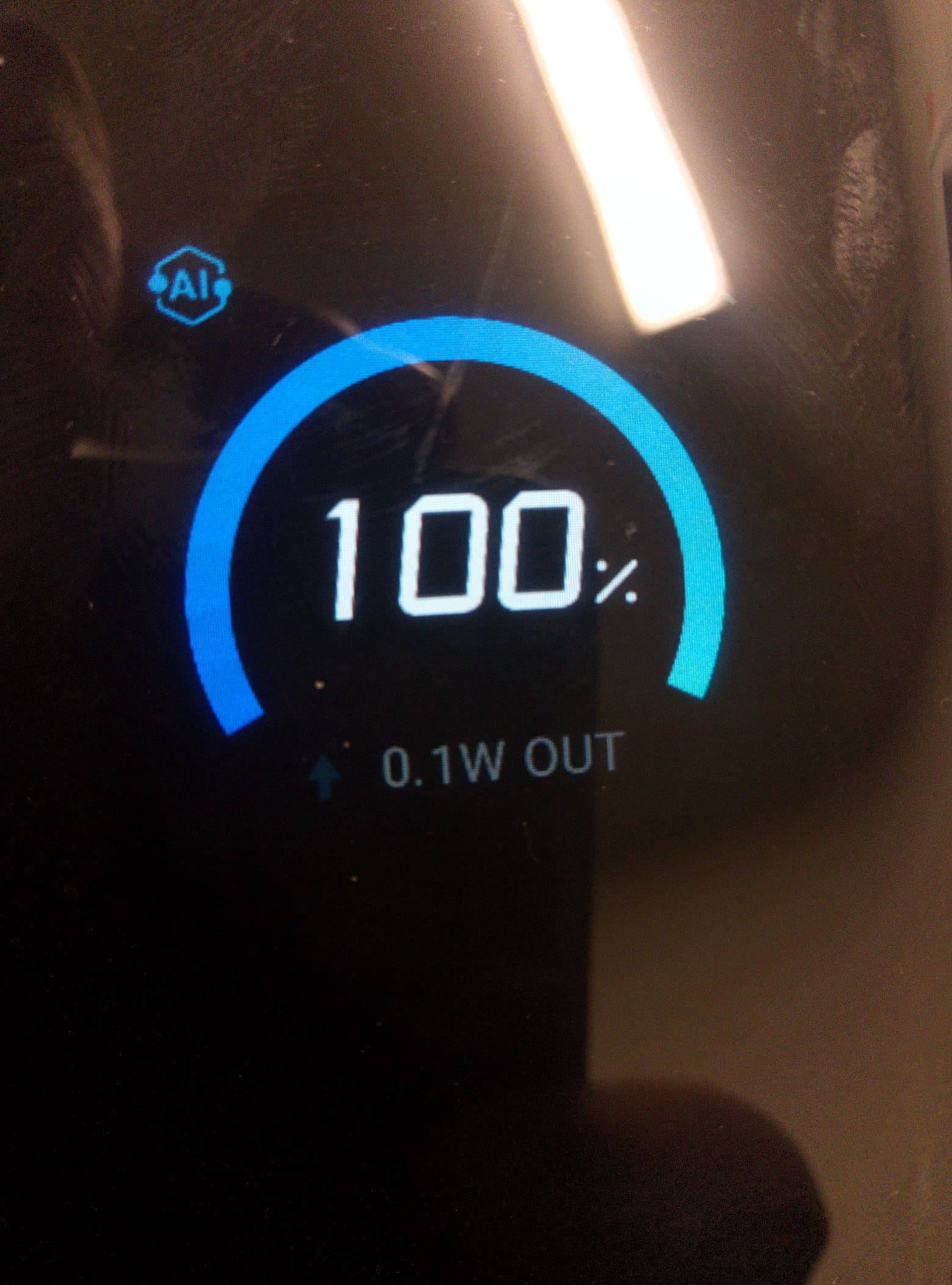

i got the big 26000 or 36k h one. it arrived and all i did was take it out of package and plug it into to librem 5 and it wasnt working. it kept fluxuating between around 2w out and .01 or .05 w out. so the phone would show the charging icon and then not charing. just off and on again.
this battery pack comes with some smart technology or something maybe thats interfering? (i did not charge the pack just used the charge it came with at 13%). i used the fancy cord it came with as well as my own that works and it did same thing. i tried the new cord in my car outlet and it worked so ruled out cord issue.
any ideas. this pack was expensive lol.
Try charging it? 13% is kind of low.
Definitely, always charge a brand new battery to 100% before use. Also, try it with other PD fast charging devices if you have any available. The Librem 5 can be flaky sometimes but you want to rule out a fault with the bank itself. Also does it explicitly support PD power negotiation? Worth verifying.
its doing the same thing. it switches quickly between a higher out put to a .1 one. and the librem goes back and forth between charging and not. phone is up to date. i’m not sure what the other things are you mentioned. batter pack is brand new and costs over $200 (i got good discount joining their club and paid less) so i would assume its a robust one and can do anything. ill find another smart phone and see if it charges it.
edit: tried another smart phone. apparently 6 watt out put is low. theres was getting 15 to 16 w out put. librem 5 jumps all over between 6, 4, 3 1 always going to .1 then to another number then back to .1. any way to fix this?

For a serious answer, the issues can be from several sources:
  1. It could be the Librem 5 charge controller needs a reset.
  2. It could be the internal battery is having issues.
  3. It could be the source battery is having issues with PD delivery.
It looks like you’ve explored (3) by charging a different phone.
To test 1 and 2, there are lots of things:
a. One could try to reset the charge controller. There used to be an official link, but I don’t see it. Librem 5 not charging
b. I think that one can poll the charge controlling system ( ??? see Optimizing Battery Management on Linux Phones: A Dive into PinePhone and Librem 5 - #38 by granemar ).
c. If you have a pass-through USB-charging-tester dongle you could get some diagnostics out of that … combined with the standard corded charger to see if the corded charger has the same issue. etc.
