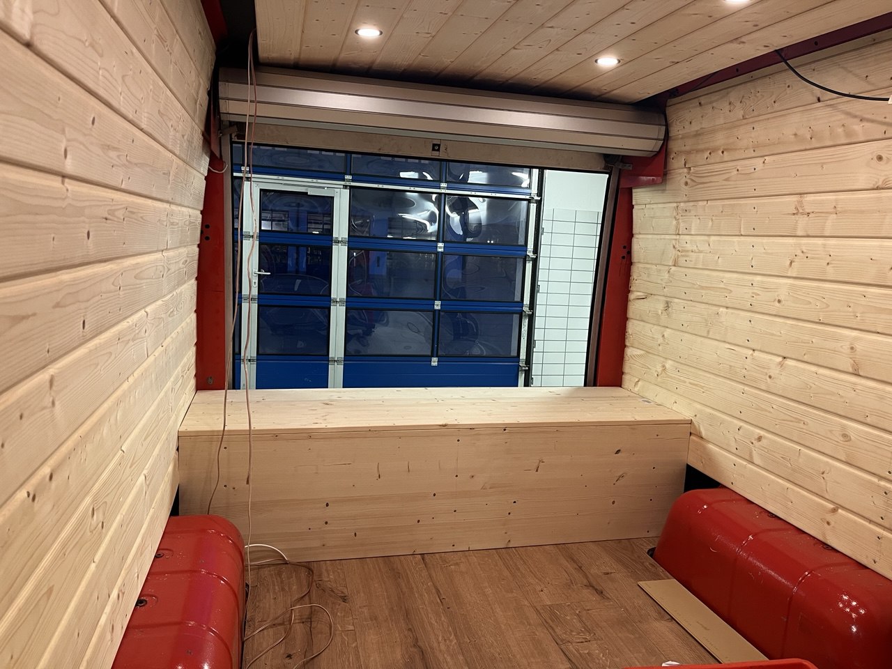

Just for the background two photos below. The one shows the car the other the inner part in construction.
Technically the car has two batteries: one lead liquid battery for starting the engine (100 Ah) and another one for the “home” (200 Ah LiPo4Fe). This one is connected to the starter battery over a relais and gets charged only when the engine is producing electricity. Later it will be charged by solar panels. Both are 12V.
The idea was/is to mount USB (A+C) sockets to the wooden walls for charging cellphones, laptops etc. I see now that they should have something in addition behind the sockets to produce at least the correct voltage or even protocol. I will look for it.

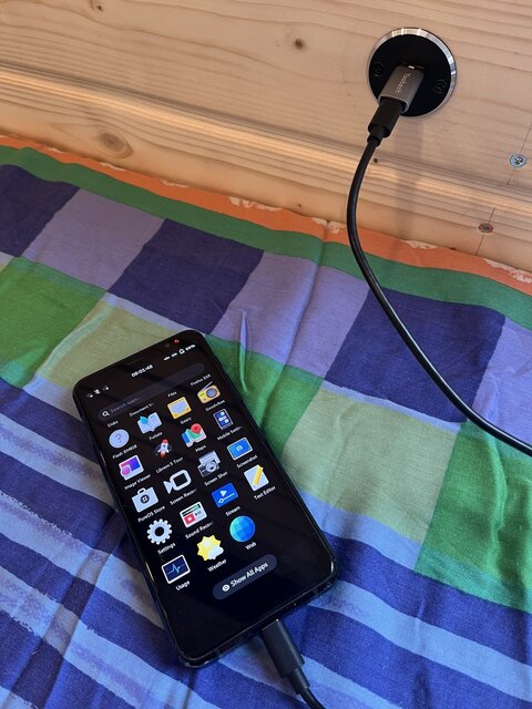

Meanwhile we’re a little further with the USB sockets. It turned out, that the sockets itself has electronic inside and adjust the 12V DC to USB. Its specification says:
material        CNC-milled aluminium
voltage         input DC12V-24V
dual connector  USB Typ-A + USB Typ-C PD + QC3.0
output          5V/4,8A, 9V/2,7A, 12V/2A```
With a L5 connected, the following happened in that order:
  1. L5 connected with USB-C cable, does not start charging, also not after turning the USB-connectors on both ends
  2. Using an USB-C to USB-A adapter (as shown in the photo), charging starts fine.
  3. Removing the adapter, charging starts now also but makes at start a scratching noise for 1-2 secs and then the seconds of the clock in the bar or lock screen give with any new second a tick like an old wall clock does.
What does this mean? I will for safety only charge using this USB-C to -A adapter.

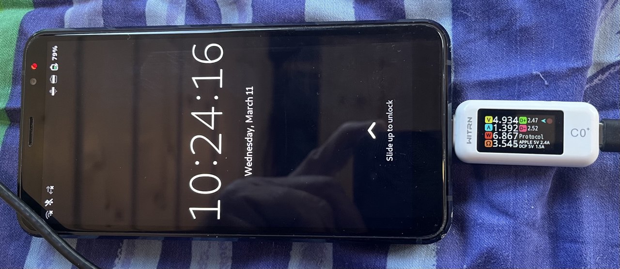

I used a meter inserted into the USB-C port of the L5 for both cases (i.e. using the USB-C port of the socket and the USB-A of the socket with the adapter). In both cases, it shows the same picture, see below.
Also, without the meter, what I described about the direct USB-C connection and the noise did not happened anymore.
That actually looks OK.
