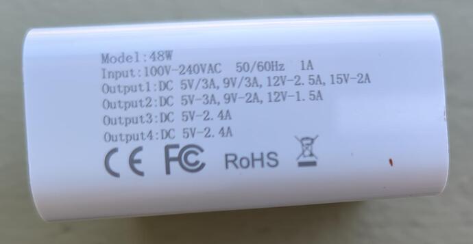

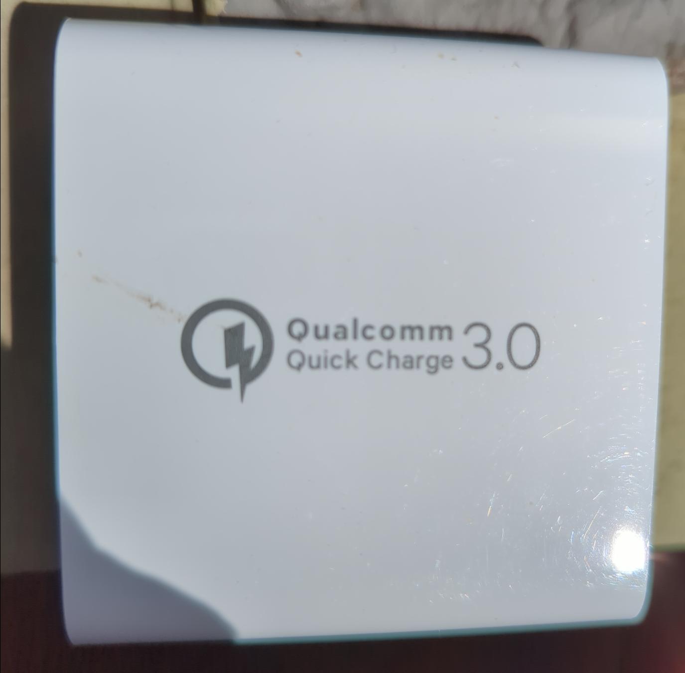

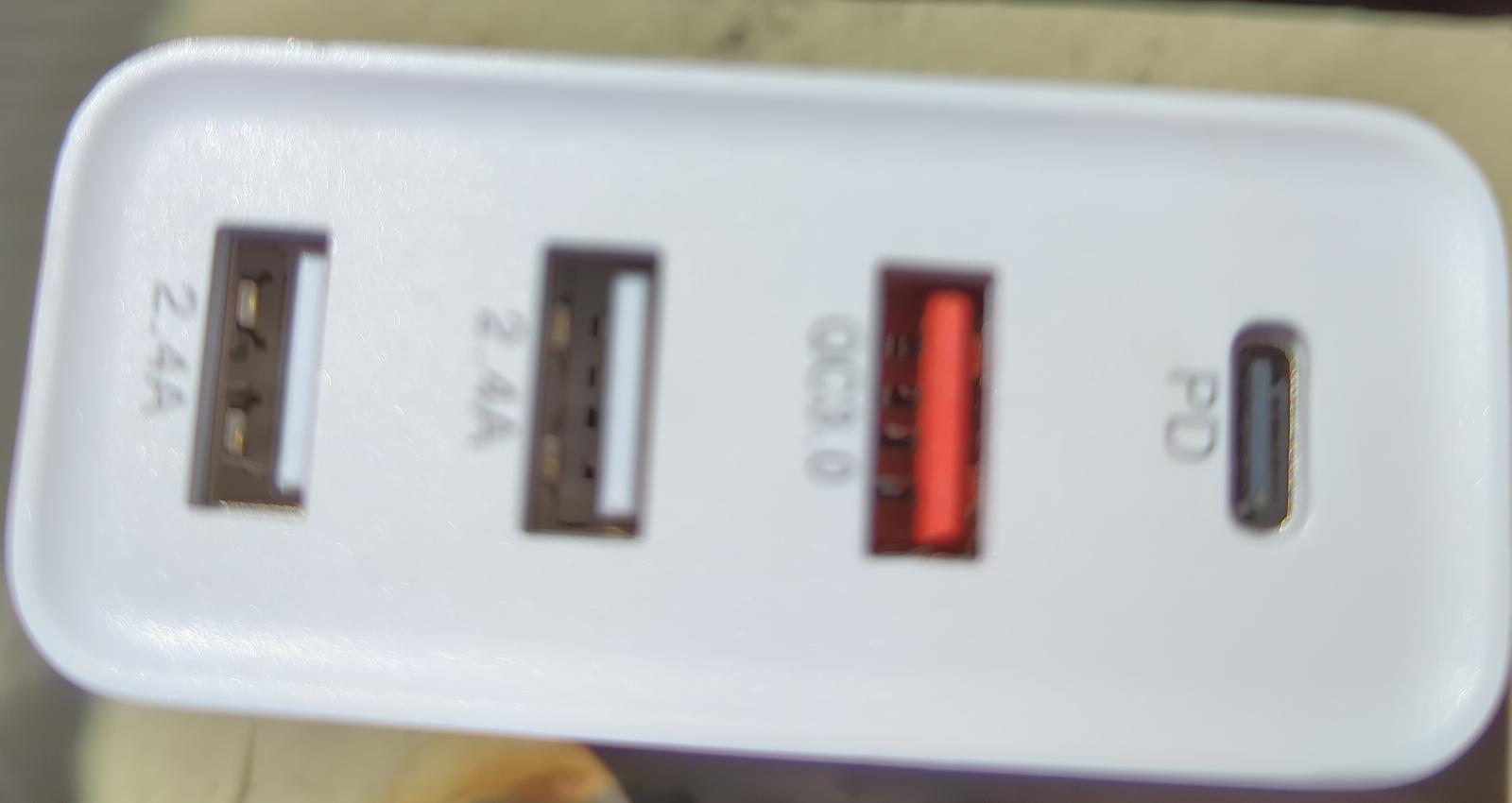

Thanks, @dos . But I think we bricked the L11. It booted fine but it does not charge anymore and the battery now is empty :frowning:
I don’t know much about L11, but I don’t think it depends on software for charging. It’s not a PD complaint device though, it requires a power supply that provides 12V which is optional in the spec, so make sure you use a charger that actually does provide it - checking the wattage alone is not enough.
Thanks. I have used the chargers from my L5 devices, saying also 12V but I only see 9V when measuring. Can someone please post a photo of the original L11 charger to find it here in my dust. Thanks.
