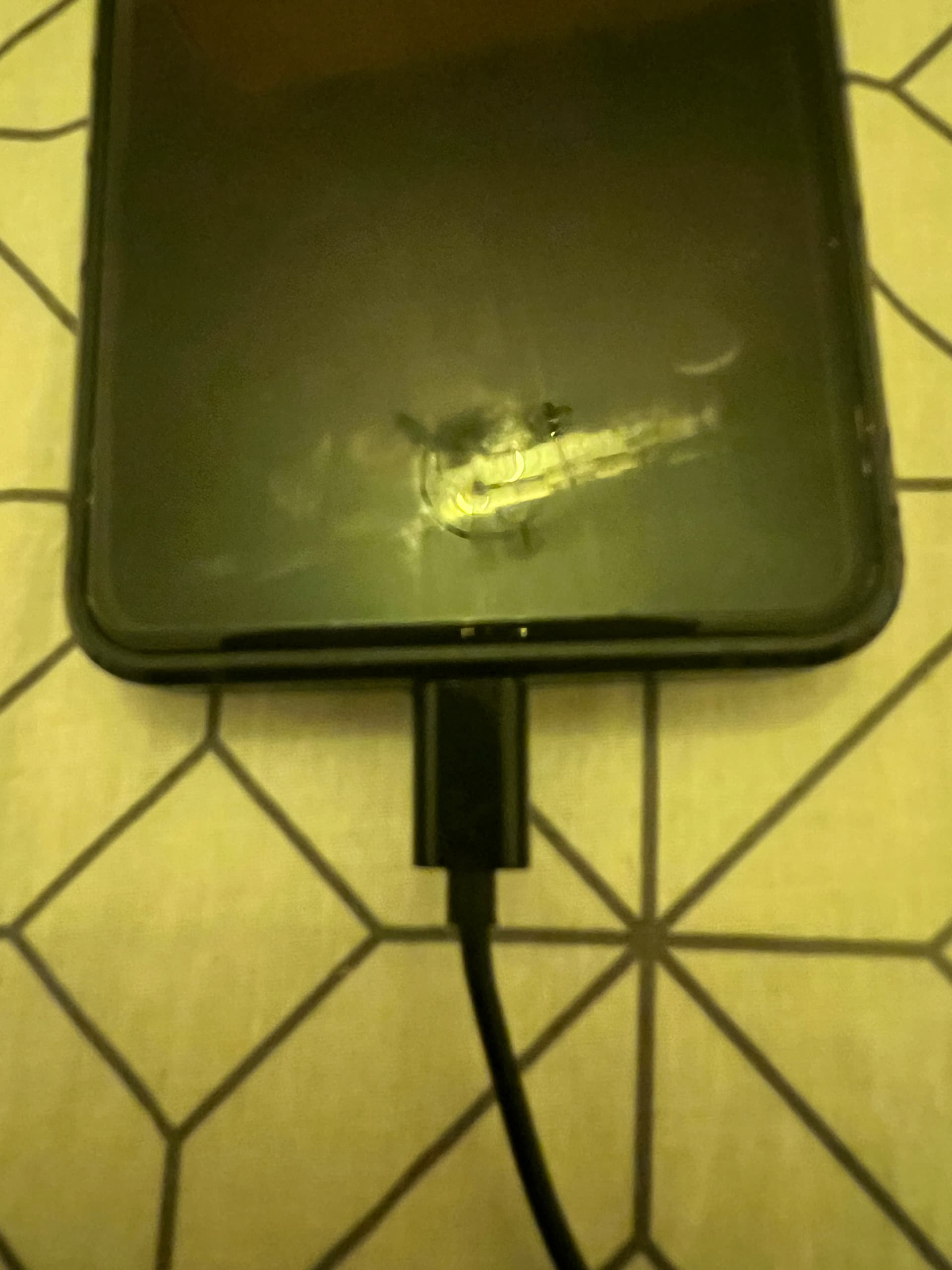

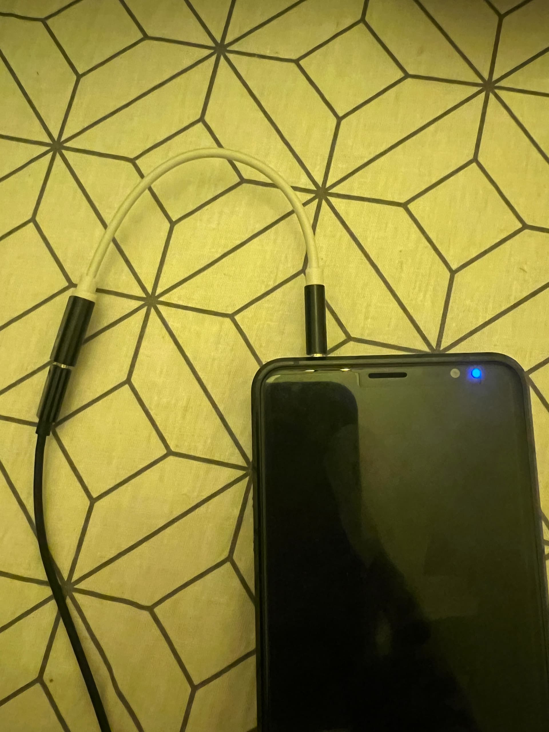

Please I need help/info: I bought air tube headphones with usb type-c connection and I also bought type-c → jack adapter to use it with Librem 5 throw jack connection. Unfortunately it doesn’t works :worried:
I did test:
  1. play music using invidious/yewtu.be using L5 speakers. It worked! I listened music
  2. then I connected air tube headphones using type-c and music continued exiting from L5 speakers instead switching into headphones
  3. then I connected type-c → jack adapter to headphones and I connected it to L5. Music paused. When I tap play, no music at all: no into headphones neither from L5 speakers!
Maybe I should buy analogic/digital adapter to connect headphones+jack → A/D-adapter → L5?
Thank you :folded_hands:

First tested it on my old Android (it has jack too!):
  1. yes when connected on usb type-c
  2. no using jack
On L5:
  1. usb it works just on settings audio testing it (front left and front right). Also micro is working! L5 automatically recognises headphones connected but when I opened Firefox on yewtu.be and tested a song and also downloaded .mp3 and opened it with default L5 app for music, sound exits from L5 speakers as I don’t have headphones connected! I looked for Firefox settings audio without success. So it works only into settings → test
  2. when connected by jack using adaptor same as android: nothing (neither from speakers)
That makes me crazy :face_with_spiral_eyes:
