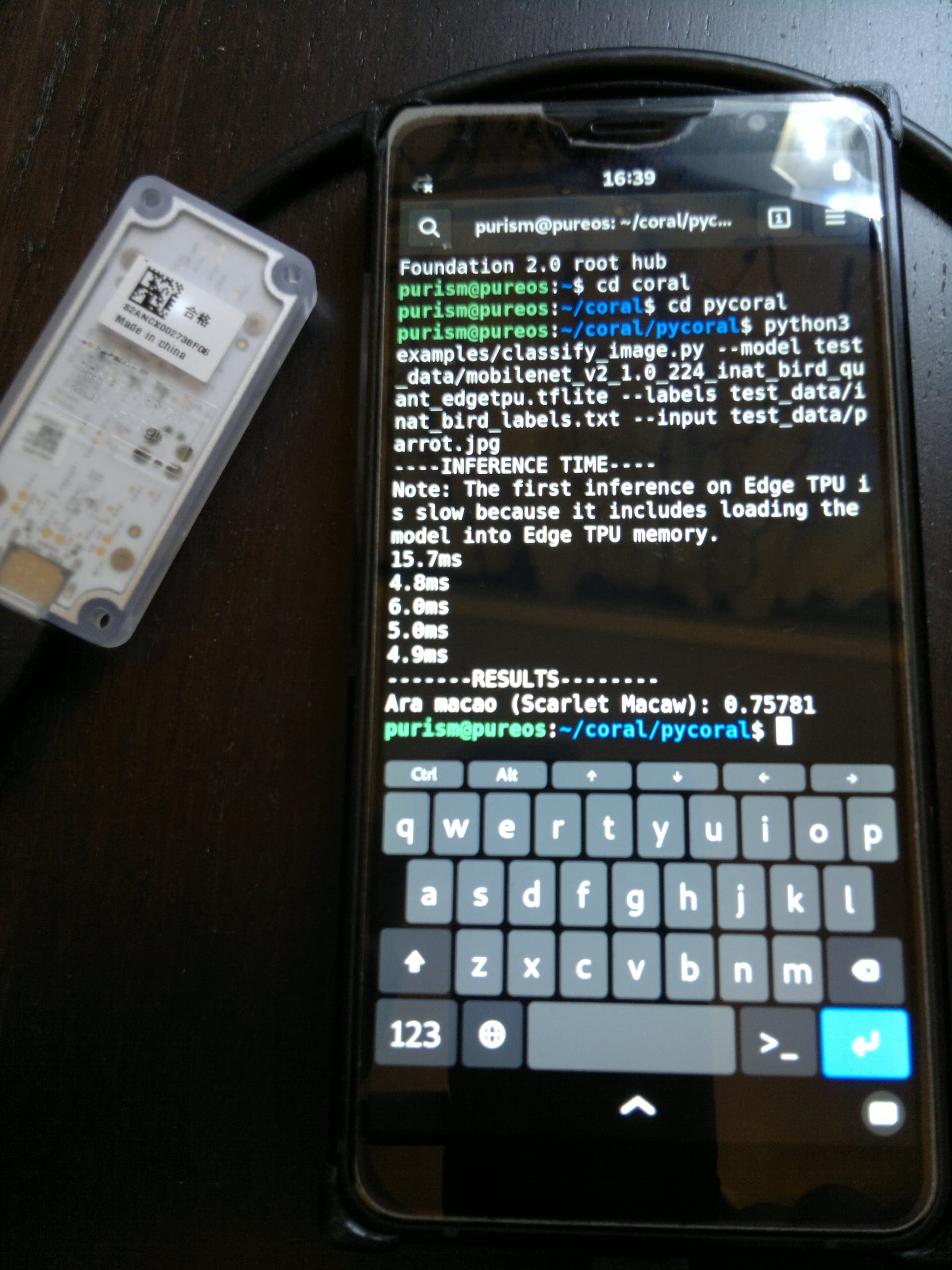

Short version: It’s possible to add via L5’s usb port an AI accelerator that seems to work pretty well. In theory Coral may add some calculation power for some DIY AI applications. Easy to set up but the rest is a bit of a mystery…

Based on the test example, performance on L5 is almost the same as with a more normal computer. It’s possibly the only way to give this kind of performance to L5 (Intel did make a couple of usb sticks for AI computing but they seem less capable and have worse form factors to connect to L5). It’s small, energy efficient (although that is relative and debatable with L5’s already limited battery) and has decent support/documentation.

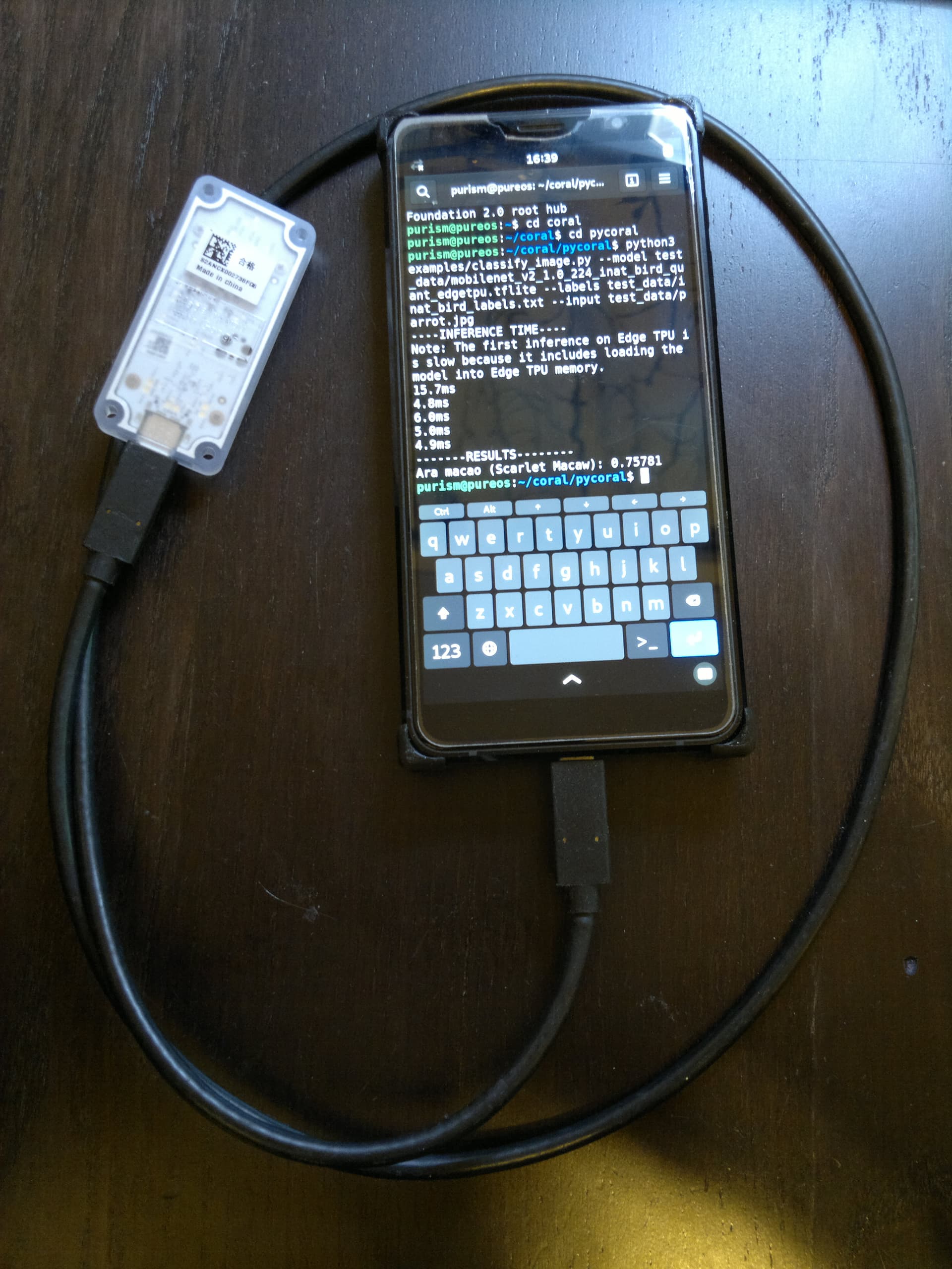

  • First, it is external and takes up the only usb port, so you may need to set up a hub or a splitter to keep the phone powered, but it does offer un-tethered offline addition.

If you have PureOS byzantium (debian 10), then you can just follow the guide on Get started with the USB Accelerator | Coral In addition to that, you’ll also need to install curl, git and do some extra steps in the end to add udev rules (see bug fix from: https://blog.stackademic.com/google-coral-usb-accelerator-on-linux-a3201e7936a8?gi=fab44b18380c)
If you’ve installed Crimson already, I don’t know what to tell you. I’m hoping someone is interested enough to do a how to on setting up a separate pyenv for this - I tried doing it using a couple of sites, but couldn’t get it to work with the stick.
Oh, and btw, if you use the cable that come with the stick, usb A-C, and need to use an adapter to make it C-to-C, don’t use OTG adapter. If longer cable is ok (like for this testing), the original L5 charging/data cable works too.

I’ve only done rudimentary testing so far and won’t be doing anything on it for some weeks, at least - you are welcome to do your own. This was a proof of concept (PoC) that it’s possible to use it on L5, nothing more. It will not magically add AI to everything and is not identified by anything out of the box. It’s a solution if you need in-device (offline) AI computations and L5’s specs alone aren’t enough (see for example Ollama tests).
The rudimentary tests showed that it works nicely offline and thus is un-tethered to the big bad G. The L5 as a hardware platform and linux as a software platform gives us control to do this kind of tests, but it’s another thing to take such “to production”, use them with your daily driver/phone. In those cases I suggest thinking about how to verify the controls/blocks, maybe set up some specific firewall rules or confine the code and apps in to a virtual environment etc. - just in case, as is good practice.
Coral can be found second hand, or even unused, quite well and prices are around 60-140 $/€. I don’t think the usb version was ever very popular and both built in and GPU power surpassed it and its usefulness quickly. Yet, it seems like made for L5 and for tinkering for your own special private projects - like anything image/video related (it would be nice to have it pluggable to camera software and have it identify things). Coral could be fitted and taped (or screwed) to the back of an L5. Just needs a suitably short usb C-to-C cable.
