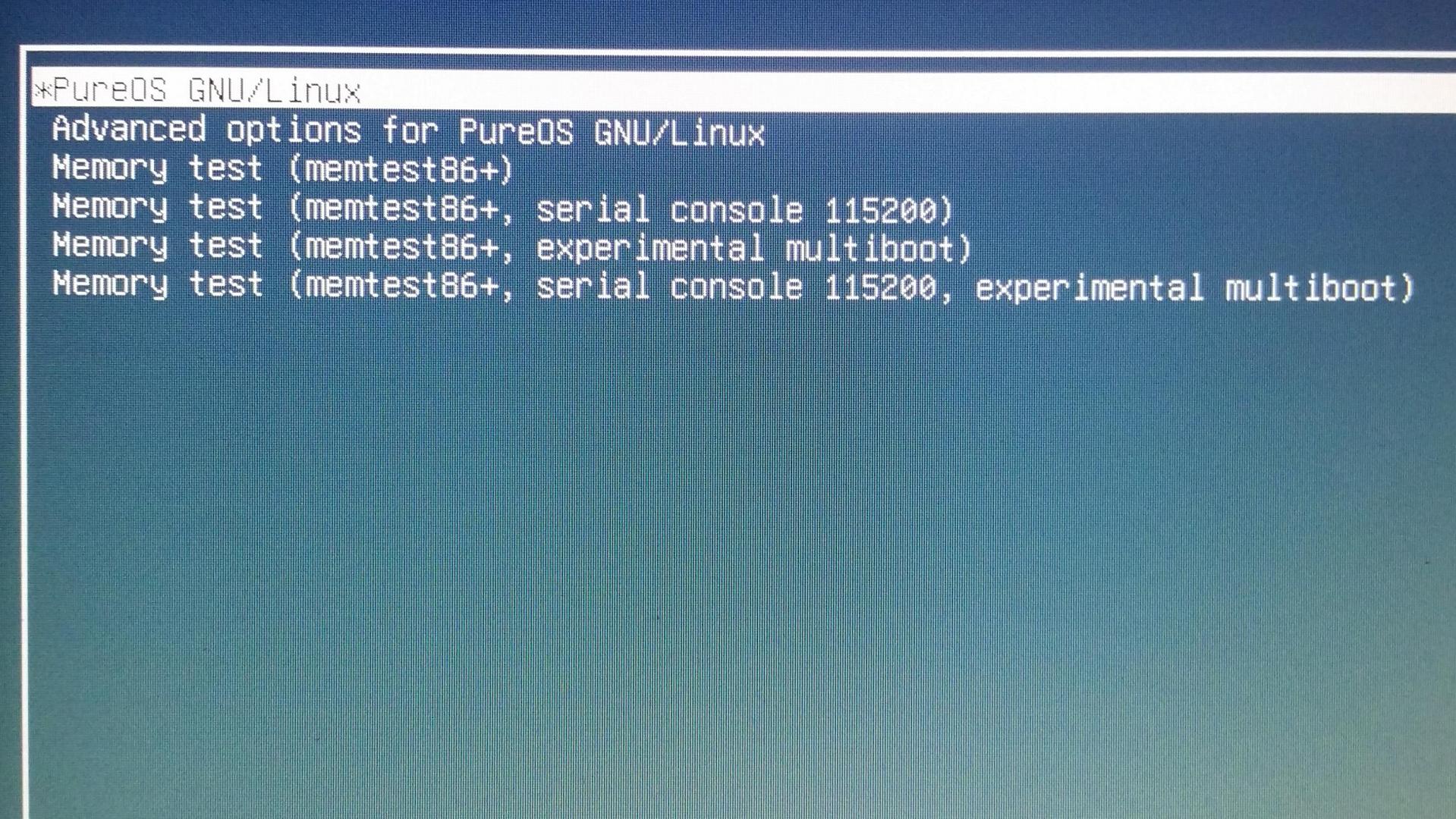

Issue with memtest in coreboot, use the memtest from grub bootloader, it will work, or wait until we release a fixed version of coreboot.
Thank you for the response, could you please explain how to use the memtest from grub bootloader? Usually I just press ESC on boot and then select option 2 for coreboot memtest.
Thank you
Restart, wait until Purism logo disappears completely and then press ESC. You should see something like this:
