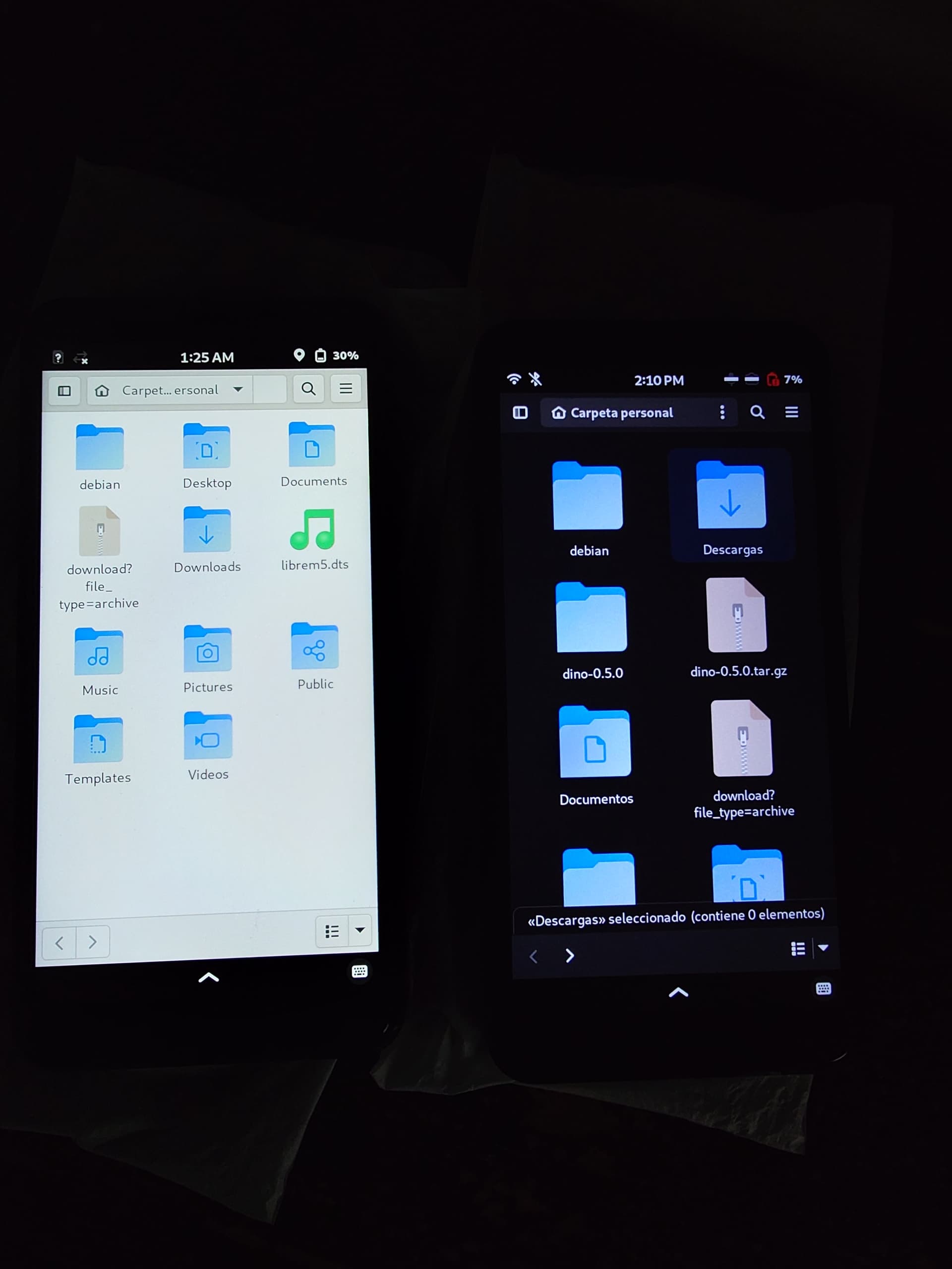

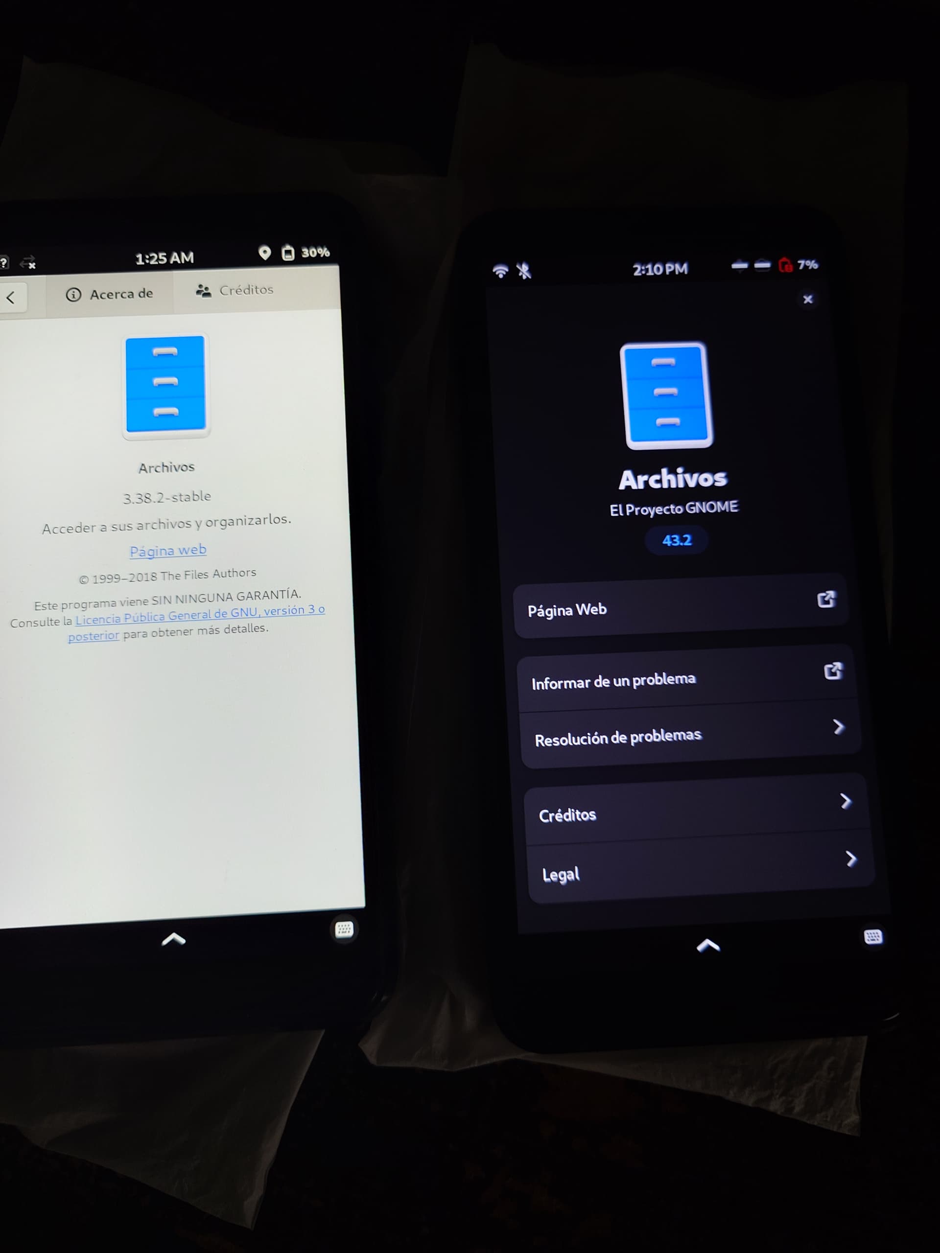

Gnome Files app it is one of big changes on crimson including black theme support.
So looks like gnu crimson it is the first mobile os to full use it on night!.

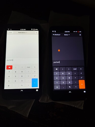

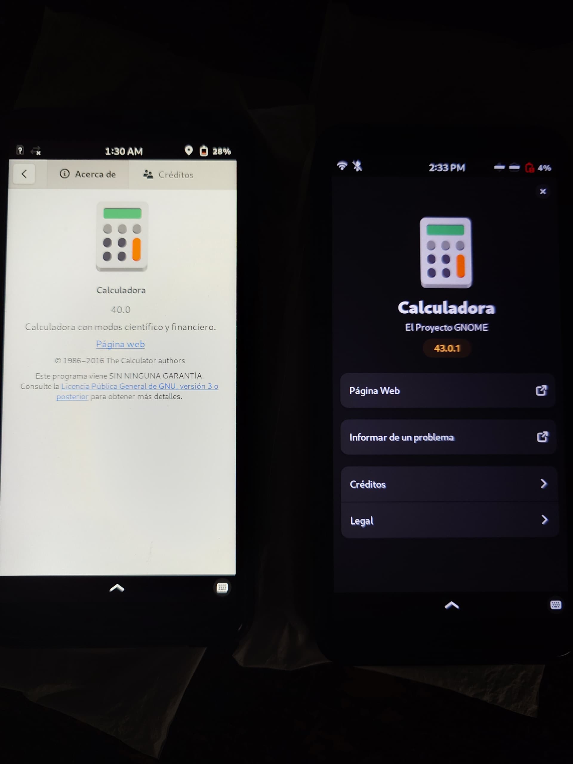

@dos calculator has a pointer bug too as you can see it.
Wow Crimson is full GTK4 feel.
