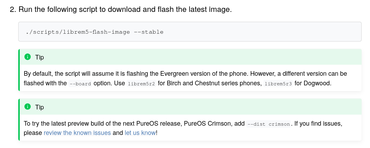

I couldn’t find the instructions in Horesh to do it with regards to crimson.
See the second tip in the screenshot above.
So I think you should use (I’m not sure if sudo is really needed, but I think for me it was):
sudo ./scripts/librem5-flash-image --stable --dist crimson
