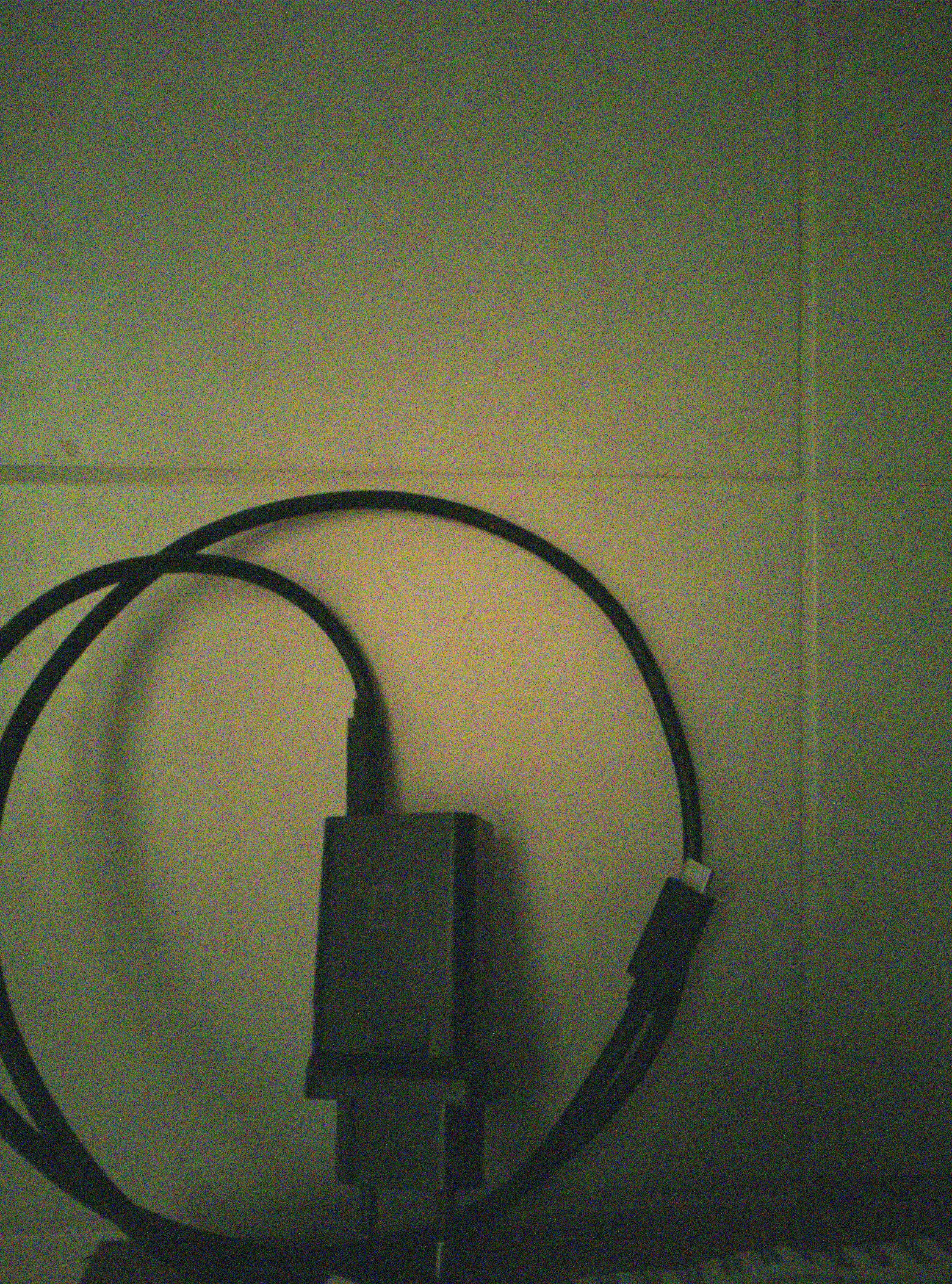

I had an idea of de-noise L5 pictures from the dark. And so I did. The original photo:

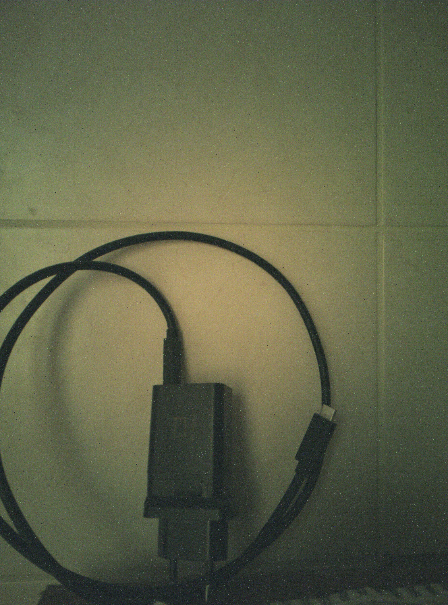

Very noisy. Also look around the logo. My de-noising result:
Looks great, doesn’t it? You don’t even need to make the picture full-size to see the differences. Like a completely different camera. And here’s the clue: I just used the JPG-files to improve the image quality. No raw-files, no darktable. So it could be improved even further.
But there is a downside. The technique required 32 pictures of the same object and the quality improves via square root → that means further improvements need much larger amounts of pictures. So I thought the other way around: what is the minimum amount of pictures where I don’t see any improvement when just adding one single further image? The answer was 7, so I took 8 pictures to create this:
You still see a quality difference to 32 images, but you don’t see difference between 8 or 9 images. You need many more to make the improvements visible.
If you want to do it by yourself:
Take all the images (amount depending on your quality needs), put them all into GIMP or similar software and blend them together. The best quality I got with GIMP doing it this way: Opacity of the images, start from bottom is 100%/n. It looks like this:
Image 4 = 25%
Image 3 = 33.3%
Image 2 = 50%
Image 1 = 100%
I also could use the sharpen-filter since my focus was not perfect on these photos.

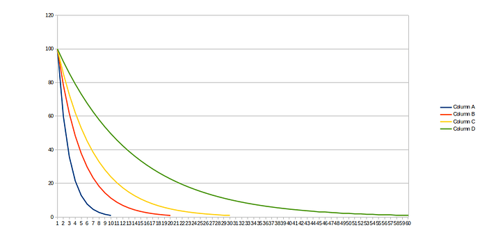

Hey, @Ick - looking at your numbers, is that logarithmic…? Or some other sequence? Approximate logarithmic opacity percentage graph for 10, 20, 30 and 60 images would look like:
Is that about right? For ten images the percentages would be: 100.0, 59.9, 35.9, 21.5, 12.9, 7.7, 4.6, 2.8, 1.7, 1.0. Can you test how that seems with your images?
And there’s no point in using like 5 or 7 pics for this - even when using more linear numbers?
I deleted the images already, but could create new ones. However, when I look at your graph I have the feeling it doesn’t work as well as my numbers and I don’t even think a test is necessary. Here is why:
After 10 numbers your opacity of the blue graph is already at 1% while my row is on 10% and even after 60 images still on 1,67%. So your numbers tell me, that more than 5 images it makes no improvement. anymore.
On the other hand the first numbers are higher than 50%. Let’s just combine 2 images together. Why should the second image be more important than the first image? After combining 2 images, the information of the second image is 60% part of the new image, while the first one is 40%. The result is the same as the opacity of 40% (first image 60%, second image 40%). With the green and yellow line, it becomes even worse at this point. For green I need around 10 images to get a opacity of 50%. So the 10th picture deletes 50% of all information of 9 images together. That doesn’t sound right to me.
As I told, my math was y=1/n while n is the image count. This math has a sense:
1 image = 100% opacity = each image has 100% information
2 images = 50% opacity = each image has 50% information
3 images = 33% opacity = each image has 33,3% information
4 images an so on …
To prove the 33,3%: The first image has 50% on step 2. On step 3 image one and two together contain 66,7% of the information, multiplied with 0,5 (50%) is 33,3% remaining information of the first and of the second image.
Does it make sense?
It does and due to the logarithmic values I was wondering myself how it was working with them (as it wasn’t). For some reason I didn’t register the 1/n.
But I still didn’t get, why the 8 image limit. Was there no improvement with fewer images?
There is no limit. You can use everything from 2 to 2000000 images. Of cause the best quality improvement of each step is combining the second image. 8 is just a kinda sweet-spot. On the one hand, 7 images is where you can see the improvement with each step and 8 is thought as “there are may images where you can even see an improvement to this step”. But 8 is also a number computers like very much (2³=8) and even if it may makes not much sense here, it’s a number in my head to prefer choosing it for computation tasks.
So really, just take the amount you want.
