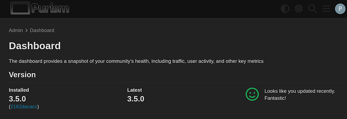

I have manually upgraded postgresql from 13 to 15 (took an sql dump, upgraded postgres and restored it). This is now available for testing at https://forums-staging.puri.sm and on version 3.5.0 (we switched to stable from default test-passed). Give it a try and let me know if you see any issues. If the new version is satisfactory, we can update production later.
If we don’t see any blockers I will update on 26th at 6am UTC.

Seems like we’re updated and… so far so ok. For anyone that hasn’t noticed, in this new version, there is a button one the left side that allows to switch between new (default) and old modes to edit these texts.
