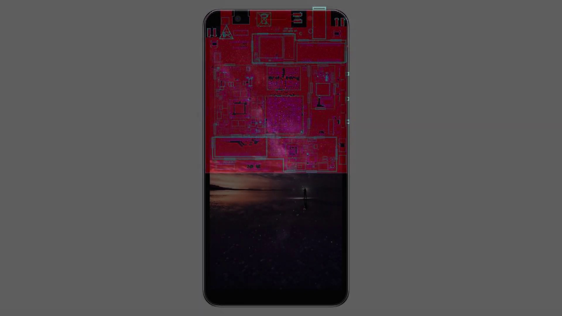

I think the battery will be a fat one. Below is a pic from the pcb above the phone. I expect modem and wifi to gonna sit on top of the main pcb. So half of this 5.7" phone will be battery. And the phone it self will be a fat one too. (around 14mm is expected i think)
