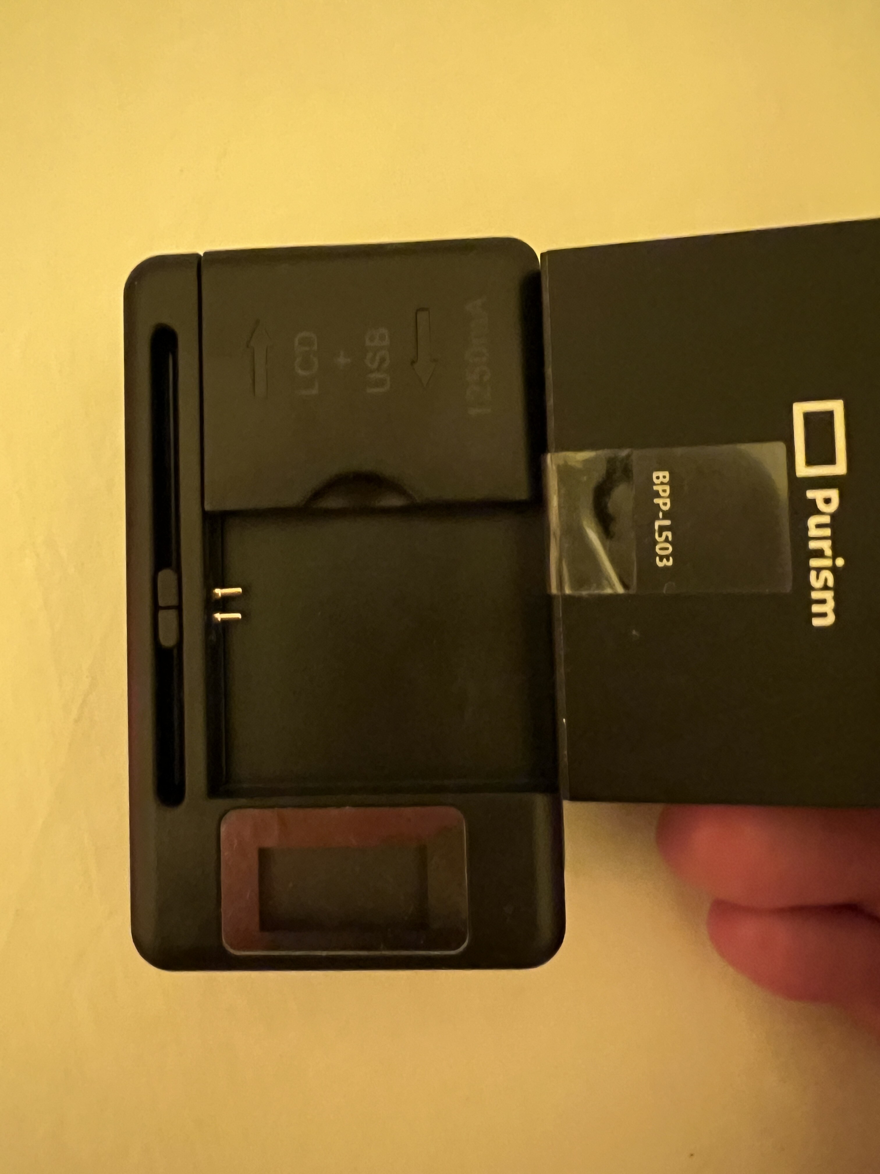

Yes, I did it! Till the end but smaller than battery. Maybe I bought a different model:
As you can see, battery takes to the end of the charger! I would have to break the sliding carriage in order to place it all in the charger
That’s so weird!! It seems same I bought on Amazon but how can battery fit it if max open is 55mm instead L5 battery is 60mm?
Yes this looks different
