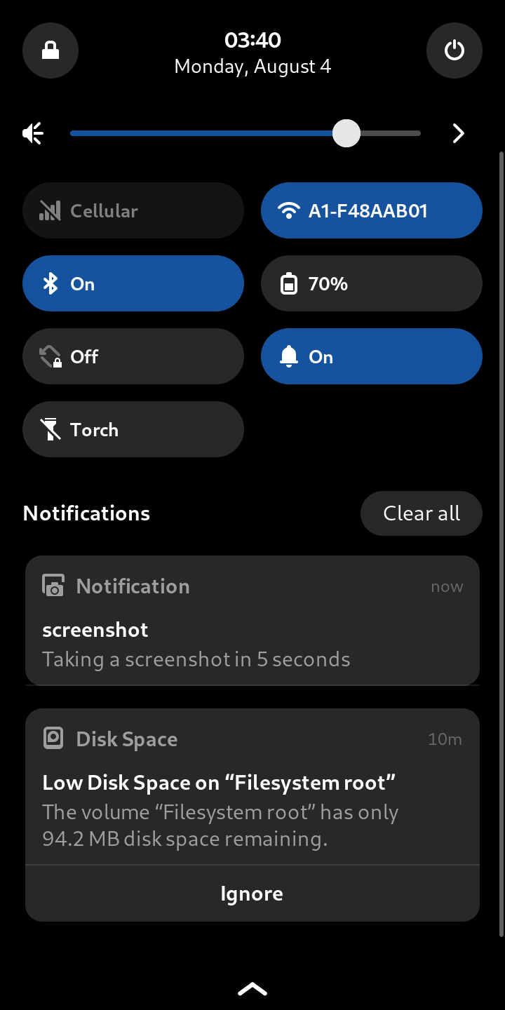

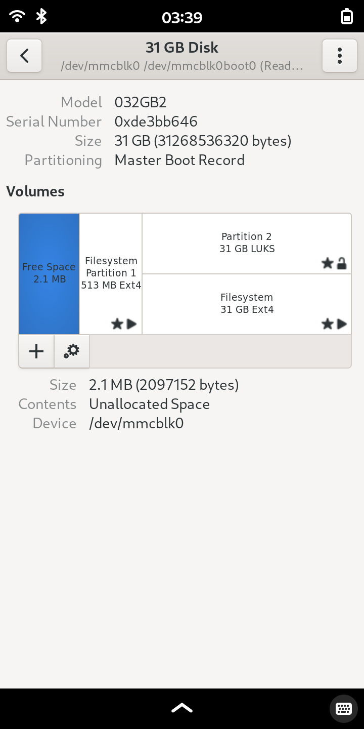

thank you for that! I wasn’t able to just install crimson beforehand. Now this was fresh and easy. :slight_smile:
The thing is that I was greeted with the “low disc space notification” and therefore I won’t use the luks variant. Maybe this issue will resolve in future crimson luks variants, but I am okay by staying in plain file system. :wink:
Maybe it is possible to resize via ssh connection or jumpdrive, but I am good with the solution I have now. Just wanted to test the luks variant.
I am only a user and I can only use what these great developers achieve. Thank you all!
Regards,
Alex
Actually, you should have all disk space, the warning is probably the result of a race condition, see: First boot gives low disk space warning (#51) · Issues · PureOS / Tasking · GitLab
