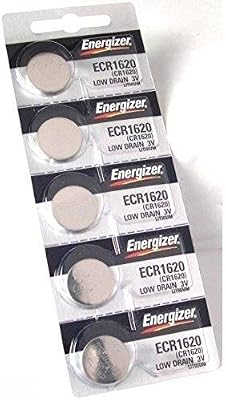

Electrically, it would work, but CR2032 is approximately 1 millimeter bigger in diameter and width so it might not fit.
Strange that you couldn’t find this:
I performed a test with a voltmeter on a Librem 13v2 CMOS battery and it measured 3.1V. In the Librem there isn’t a custom-made plastic slot for the CMOS battery, it sort of sits there between a few components so I think a 1mm diameter difference shouldn’t matter much.
I did find the CR1620 on amazon but they do not have the wire leads necessary to plug them into the motherboard. It was a snug fit but I managed to cram the CR2032 between some components.
