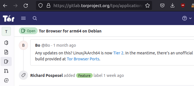

Looks like the only thing currently available is UnOfficial Ports. I run it at 175% Display.
Looks like the flatpak is only x64 whenever I try to install it.
https://sourceforge.net/projects/tor-browser-ports/files/11.5.8/tor-browser-linux-arm64-11.5.8_en-US.tar.xz/download
