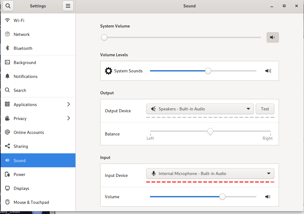

thanks. I’m rather new here so I don’t know how to perform that. I did check in the Settings under Output device but there are no option to select headphones. I have Librem 14

Can you manually select headphones in settings? If so, then it’s still using the old verbs, which would happen if either coreboot or the EC firmware wasn’t updated. If not, then it’s using the new verbs, but the jack detect implementation isn’t working.

I don’t see headphones in the settings
