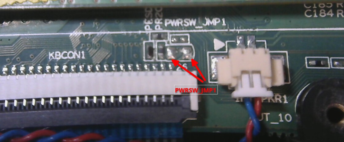

So my first idea was: abandon all hope of fixing the keys, remove the keyboard connector and use it. But, now i have no idea how to turn it on :slight_smile:
So, Question: is there a way to turn it on via a USB keyboard? Is it possible to solder a switch for a makeshift power button? Any other ideas?
There is a power button in pcb in L14, i not sure if same on L13(looks like a button close to ssd socket but i not sure)

Yes in L14 the main power button is together with keyboard too, however there is another power button on mainboard. Recheck ur mainboard to a extra button.
interesting. I couldn’t find on L13, but I didn’t look very well on the back side now that i think about it. Didn’t want to remove the display cable so i just tilted it a little.
I’m looking at the bottom side of your L14 Repairing Librem 14 Part 2: Motherboard/Screen/Chassis – Purism and can’t see it either, so I guess it might be on the top?

Yes:
Those two pads are the power switch terminals; short them and the system will turn on. Do not be misled by the additional footprint between the silkscreen label and the marked pads; it’s those two larger pads nearest the keyboard connector.
