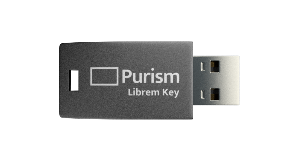

I saw a video and read the forum but I don’t understand what the Librem key actually does. I understand GPG, but what is this thing and how does it work? Do I need to plug it into the laptop every time I boot? What if I lose it? Etc. Just, anything you can tell me please. I don’t understand.

If you want to use the Librem Key to verify that the boot files haven’t been modified, then you need to have it plugged into the Librem laptop when it is booting and look at the indicator light on the Librem Key. Of course, Librem laptops can boot without the Librem Key plugged in.
You can setup the computer to automatically lock when the Librem Key is removed:
https://docs.puri.sm/Librem_Key/Getting_Started/User_Manual.html#automatically-lock-the-desktop-when-removing-the-librem-key
You can buy a new Librem Key and do a factory reset on the Librem Key and change the TPM password. See the documentation:
https://docs.puri.sm/Librem_Key/Getting_Started/User_Manual.html#factory-reset-gpg-keys-on-the-librem-key

if you plug it in a usb port when you’re already logged in the Desktop-Environment (GNOME let’s say…) you will notice that it doesn’t behave as a ‘normal’ usb-stick (pen-drive) … you will not see anything in the GNOME-disks app except your main drive …
The Librem Key uses Heads to determine whether any of the boot files have been modified. You need PureBoot with Heads plus the Librem Key for tamper-evident booting. That is why they are sold together in the shopping page for the Librem 14.

So, I"ll try to give a different example. I got the librem key and am using it as a GPG smart-card.
Once you set everything up, you can have multiple auth keys connected to the card. Every time you want to send an encrypted email, or to commit a signed change to git repo, the system will ask you to have the smarcard (librem key) attached and to type in the smartcard pin code.
As I said, you can have multiple GPG keys for different purposes all stored/related to the USB key (signing, encryption, etc).
If you lose your librem key, and your GPG keychain is not backed up, then you screwed to a variable degree. The degree depends on how important the keys were and how many peple relied on them for confirming your identity.
This is why it is not recommended to store the GPG keys on the librem key itself, but rather to generate the keys on a computer, connect the keys to smartcard, then back the private keys up in multiple copies.
This setting up process is a pain and takes time if you’re starting from scratch, tbh. But, once you do it, it works reliably.
One other thing. If you plan on dual booting with Windows, you should select the option Coreboot + SeaBIOS when buying a Librem laptop.
The Librem key holds the private key of the GPG pair.
The Public key of the GPG pair is on the machine.
Think of the Librem key as the car key to start the car. It authorizes you to, sort of.
And yes, the Librem will start w/o key as well. Try it. But then you circumvent the integrity check.
Oh yes, and the pin code secures the Librem key from being tampered with. Befor being able to rewrite the key in terms of GPG Private key or HOTP/TOTP, you must give credentials to be allowed to rewrite the key. So noone else could manipulate your GPG private key.
