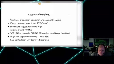

Just today I learned that Andy Müller-Maguhn, a German ChaosComputerClub member, is certain he’s been compromised (spy device inside his cryto phone) by the CIA :de: for helping Julian Assange.
Related video in :us:
If you need advice, ask this guy…
