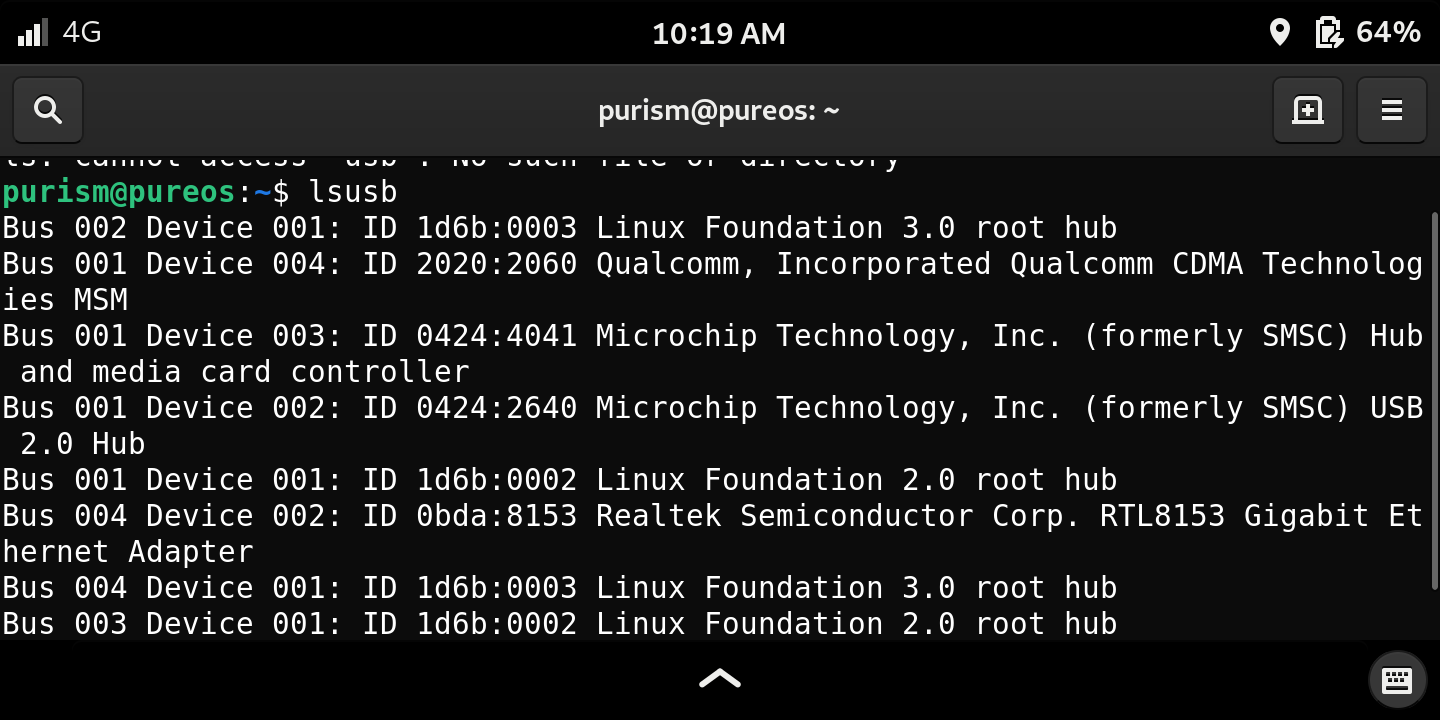

Can you please use the lsusb command to get the hub’s USB ID, so I can add it to the wiki?
The Vention Multi-function USB-C 9-in-1 is compound device with HDMI output over USB3.0 and USB 2.0 hub and ETHERNET. I have used it with FullHD monitor, keyboard, mouse and ETHERNET on Librem 5. I have not tested/needed card reader and audio. There is list of USB devices which appear when it is connected to the GNU/Linux computer
Bus 001 Device 010: ID 2109:2815 VIA Labs, Inc.
Bus 001 Device 011: ID 1a40:0801 Terminus Technology Inc.
Bus 002 Device 004: ID 2109:0815 VIA Labs, Inc.
Bus 002 Device 005: ID 0bda:8153 Realtek Semiconductor Corp. RTL8153 Gigabit Ethernet Adapter
Please tell us if you see 9636|ALGOLTEK, INC. line (easily should be present one, related to AG9321MCQ) over there? Thanks for the already given update!
