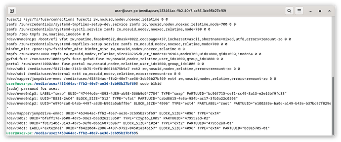

(1) Can the jumpdrive script itself be used to issue the required MMC PARTCONF 0 0 7 0 command to the non-booting L5? I assume it already issues UMS 0 MMC 0 command to L5 in SDL or FLASH mode to mount all partitions/drives as USB storage. Something like UMS 0 MMC PARTCONF 0 0 7 0 be issued via modified jumdrive script? And if is possible, how to modify/edit the jumpdrive script to issue required u-boot commands including above required to fix the booting problem
(2) Whre is/which is a bit-by-by accurate factory image file for eMMC which can be flashed to a completely erased/zeroed out eMMC of a non-booting phone mounted via jumpdrive, just in case, which can restore it to a factory default out-of-box status as Purism had intended it to be with all the required partitions restored as-is? Current flashing requires at least two images to be flashed to eMMC, one is boot and one is main OS image.

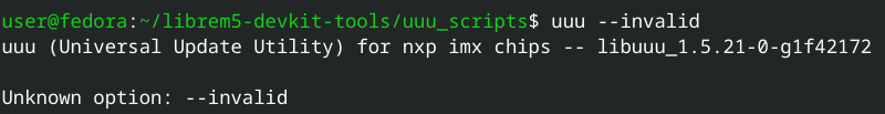

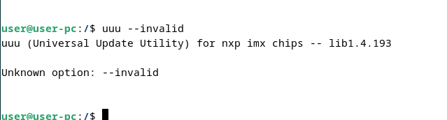

It might be as well to confirm the version of uuu that you have e.g. with the bogus command
uuu --invalid
I had the very first installation of uuu as per Purism reflashing guide, i.e.
sudo apt install git uuu
Than I also checked this revised Purism reflashig guide;
sudo apt install git python3-jenkins python3-tqdm uuu
I have also installed mfgtools_u-boot_jumdrive_u-boot-librem5-devkit-tools (all git cloned)
above was from my fedora machine, but uuu I have used to work with non-booting L5 is from my another debian machine which has uuu as snipped below, looks it is version 4.193

I am ready to plunge to totally reformat and erase the whole eMMC after mounting via jumdrive; if reflashing procedure is able to/will be able to reformat and get it ready to be re-used, something like eMMC has failed and a brand new unformatted eMMC has been just installed into L5.
I will do whatever Purism would do in that same case, i.e. after installing a blank-brand new eMMC into L5 and then making it ready for use.
Or, I assume that each partition on the eMMC can be erased and reformatted via debian disk utility. Can anyone please confirm and advise if this will make L5 reboot again. I will do that for required partition via debian disk utility once mounting via jumdrive.
