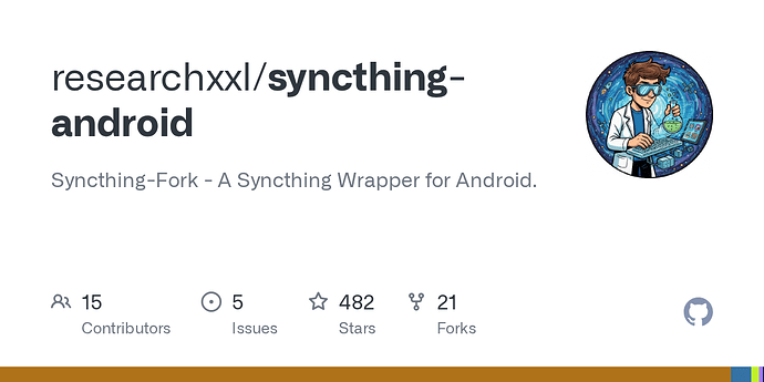

use this on android, as the official team got tired of android market requirements, and gave up on supporting android, but this fork was cool even before abandoning the official branch:
