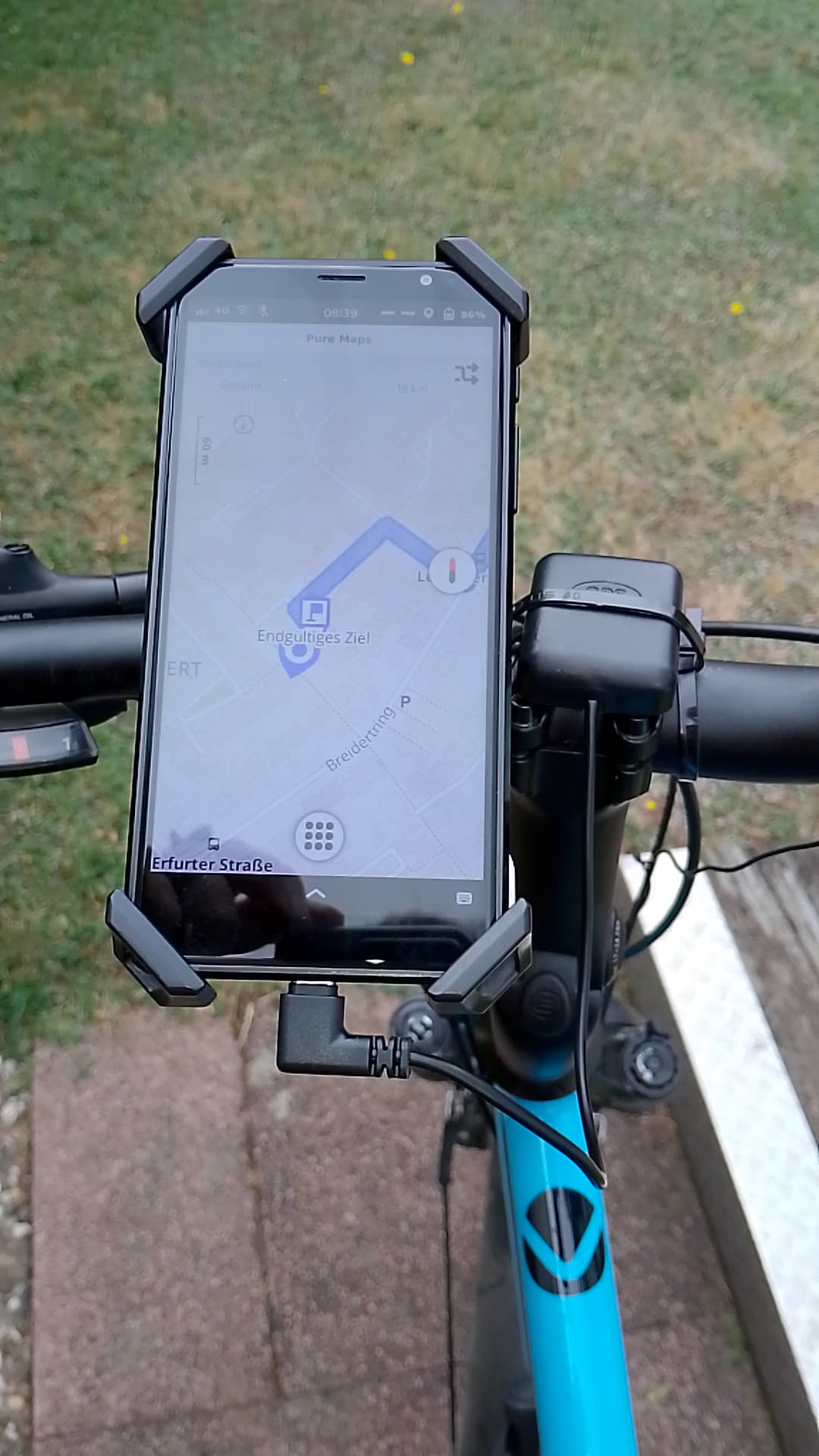

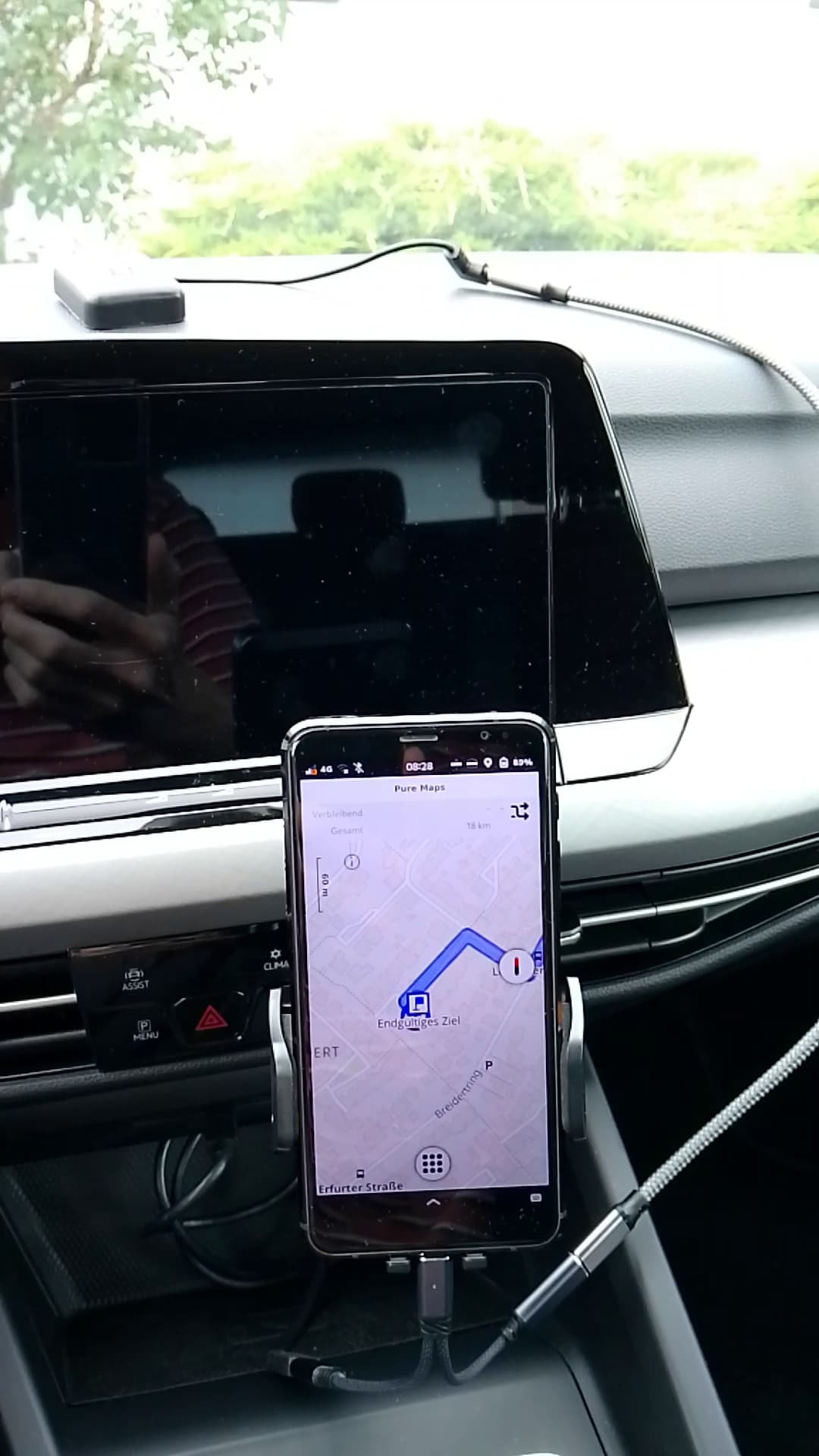

I have now bought the same u-blox gpsmouse (ID 1546:01a8). My internal librem5 gps is working well but I wanted to try if the external gps would give better results. I wrote a script, that sets up udev to switch automatically between the internal an the external gps mouse, whenever connected or disconnected.
If you want to try the script: https://salsa.debian.org/bs/gpsmouse
I have tested the cheap external gpsmouse while driving car and while hiking this weekend. After connection or deconnecting it takes ~10 sec until puremaps shows the new location. The quality with the external gpsmouse is so much better!!! While driving car the external gps also seems to receive good gps information in tunnels and while hiking it also works good under tall trees with dense leaves. That is not possible with my internal gps.
I think I will use the external gpsmouse in the car every time. While hiking, I will have it in my trouser pocket and use it, when the internal gps can’t do the job well.
I wonder if there is somebody, who knows about hardware, and who could check if it would be possible to replace the internal librem5 gps hardware with this cheap and small hardware.
Now I am using my u-blox gpsmouse for some time. And so I can give more reliable information about using it.
For me it really solved all problems with gps and the librem5. The GPS is now very fast. Puremaps is working great in the car, on my bicycle and while hiking.
Because I have two librem5, I think either the internal GPS of both of them has an abnormal bug, that makes them work slow, inaccurate and let them require to much time to get a fix.
Or if the internal-GPS behavior is normal, every user of the librem5 has the same problem with GPS. And if all users have this GPS problem, than I wonder if the described solution has been seen by all who would benefit from it. So to make it more visible I will attach 2 photos.
In the bicycle photo the librem5 is connected to the u-blox gpsmouse. If I use it, I always have a replacement battery (the battery of my second librem5) with me. I do not notice that the u-blox gpsmouse needs relevant amount of power, but I think the required monitor brightness on the bicycle needs more power. So I often have to change the battery after a few hours.
The photo in the car has a usb splitter Y-cabel to split power and data. The data cable is connected to the u-blox gpsmouse that is lying on the car dashboard. The power cable is connected to the car usb plug socket.
