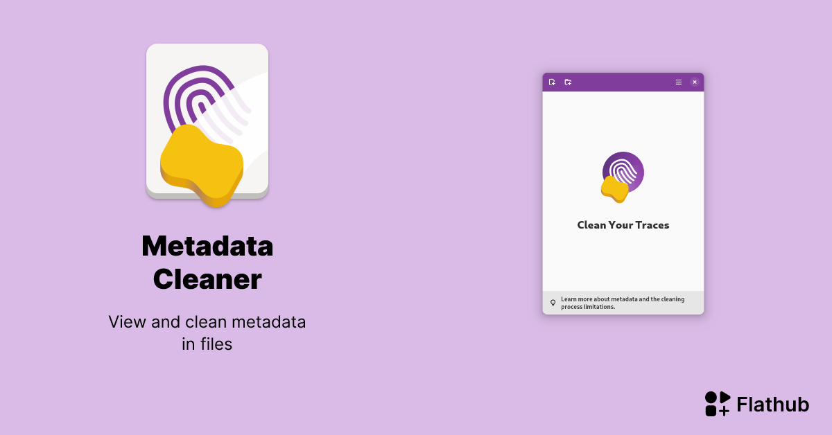

Also, there is a GTK application called Metadata Cleaner that uses mat2 under the hood, for those who prefer a graphical interface.
Brrrrr!!! :confounded:
Another flathub solution (I don’t trust flathub content).
Moreover they all occupy way too much space on the L5. :baggage_claim:
You can simply install mat2 if you prefer to use the command line instead.
sudo apt install mat2
