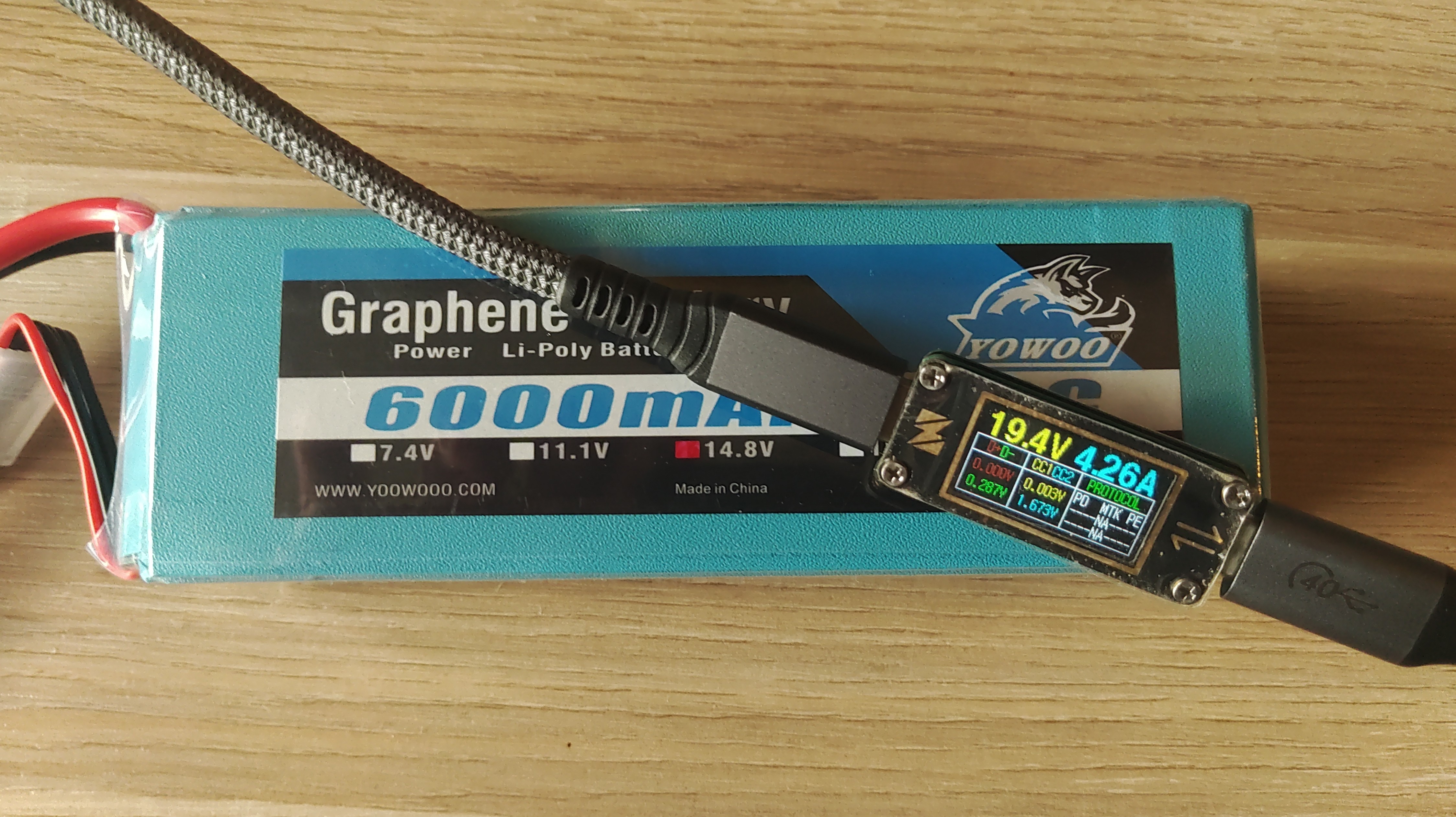

P.S. I understand above charging values as I’m getting for my needs almost 90W, from single USB-C port, just while my battery takes what it likes (not a single watt more): https://ae01.alicdn.com/kf/A3642ea51c2e745258ec930f7224211d9O.jpg and:
