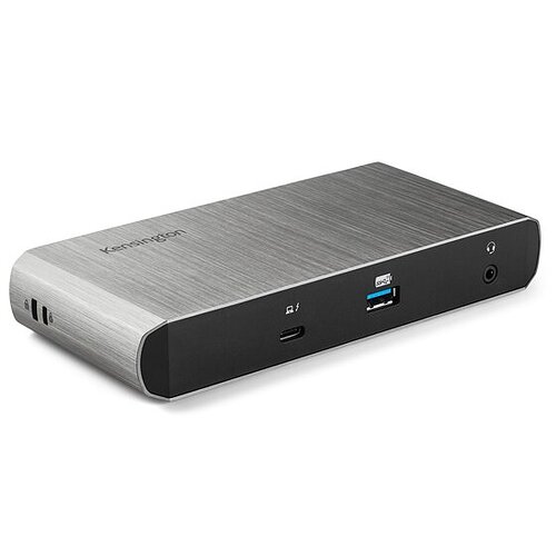

The other dock is a Kensington SD5550T, input 20V@6.25A and claims 60W power delivery throught a Thunderbolt 3 usb-c 3.0 connector.
This dock does not have a USB-C Displayport output, only Displayport native, which has a 27" ASUS HD monitor connected. This monitor is detected and used correctly with the Librem11.
