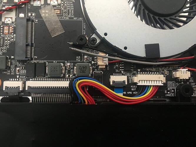

I am hesitant to buy a WiFi card because this laptop just has 2 bare antenna wires with no clips on the ends to plug into the M.2 card.
748f03a1ebc46fb9b999d870a694794d053c1524_2_666x500
Okay, you have a few options to deal with this specific issue:
  1. Acquire two Hirose U.FL female connectors, then install them onto each end of the cables.
  2. Send in your Librem 15 v3 via RMA, likely as an out-of-warranty repair, to Purism support so they can perform the above procedure.

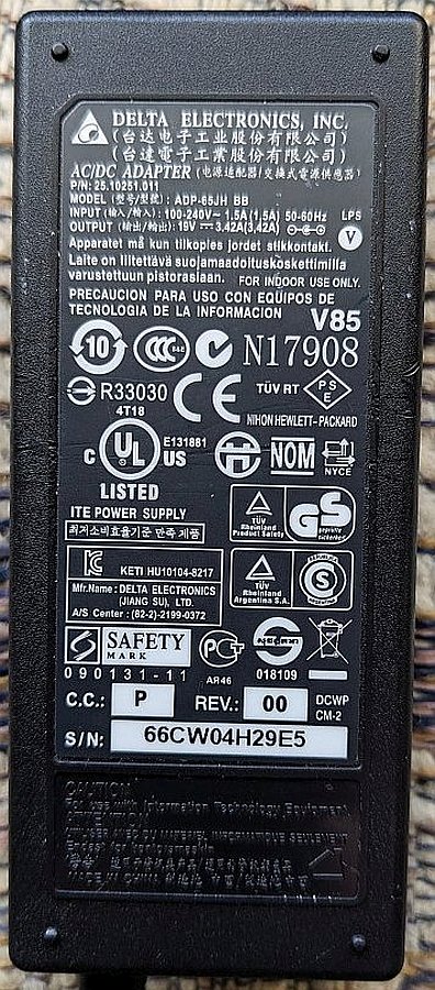

Yesterday after a few tries i managed to get Windows reinstalled on the SSD, so i left it running overnight. This morning Windows was still running and the battery was charged to 100%. For some reason the problem had disappeared. To try and reproduce the problem i unplugged the power brick from the laptop and plugged it back in. As before Windows immediately died on battery power (that is normal for this laptop). When i plugged the power brick back in, Windows restarted without a problem. But then when i tried unplugging the power brick from the wall and plugging it back in, Windows would not restart. That had reproduced the problem. Next i booted my Linux Mint USB key in the laptop and the battery indicator verified Linux was running on battery power even though the laptop was plugged in. At this moment the laptop once again will only run on battery power.
So now my question is about the power brick. It is a “Delta ADP-65JH BB” 65W, 19V, 3.42A. Is that the correct power supply for a Librem 15 v3? How much does a replacement power adapter cost?
Is it this?
But is the problem the power adapter itself or one of the connections?
I guess you also need to fault isolate the wall socket.
