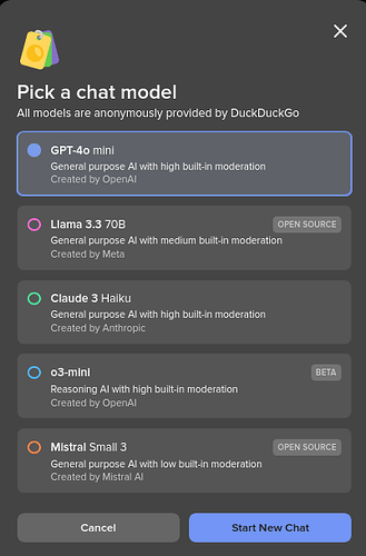

I personally use DuckDuckGo’s https://duck.ai and select between one of the available AI models they offer.
They recently added the ability to save/revisit chats, or deleting old chat sessions. There is a daily message limit (maybe 50? I can’t remember), but I find it to be a reasonable number for my needs. In general, DuckDuckGo does collect metrics on query data, but this data is anonymized from user accounts. (See their privacy policy.) I am unaware of additional pros/cons of using this service as compared to other LLM sites.
