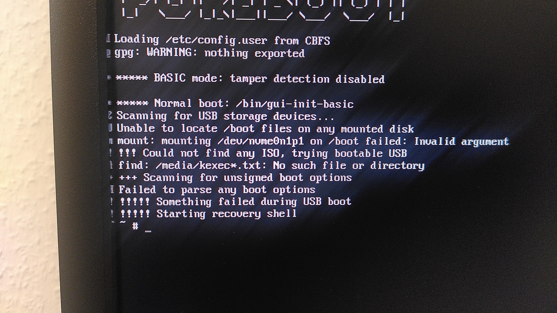

So I flashed a couple USBs (I tried Manjaro, Garuda Linux and EndeavourOS). Pureboot seems to be quite picky though and does not want to boot some of the sticks (namely Manjaro and Garuda) showing me this message:

Looks like PureBoot isn’t able to parse the grub.cfg in the Manjaro / Garuda live ISOs (they look the same).
It looks like they have some logic to enumerate the kernels on the live ISO and generate menu entries for them. Since PureBoot doesn’t execute the entire grub.cfg but just picks out menu entries, it isn’t able to find these entries, which results in the error in the OP.
It should be possible to manually kexec into the ISO to install, if you are still interested in this I could figure out the kernel and command line and we could try it. If the installed grub.cfg is simpler (likely I think but have not checked), they’ll work after installing.

This does work, I tested booting Garuda and Manjaro from the recovery shell. The steps are very similar for both.
For Garuda (KDE Dragonized Edition, garuda-dr460nized-linux-zen-231029.iso, which is latest right now):
  1. Enter recovery shell
  2. Run mount-usb
  3. Select the partition labeled GARUDA_DR460NIZED_RAPTOR
  4. Run kexec --initrd=/media/boot/initramfs-x86_64.img --command-line="misobasedir=garuda root=miso:LABEL=GARUDA_DR460NIZED_RAPTOR quiet systemd.show_status=1 ibt=off driver=free i915.modeset=1" /media/boot/vmlinuz-x86_64
    • Ignore the message about “shutdown: no such file or directory”
  5. Run kexec -e
For Manjaro, I had to go back to the 23.0.4 image dated 2023-10-15 due to the same kernel problem we identified above for Arch. The only difference here is the miso* parameters.
  2. Run mount-usb
  3. Select the partition labeled MANJARO_KDE_2304
  4. Run kexec --initrd=/media/boot/initramfs-x86_64.img --command-line="misobasedir=manjaro misolabel=MANJARO_KDE_2304 quiet systemd.show_status=1 ibt=off driver=free i915.modeset=1" /media/boot/vmlinuz-x86_64
  5. Run kexec -e
I installed Manjaro and it booted fine, so this is only needed for the initial install. You will have to partition manually and create an unencrypted /boot partition, since PureBoot requires it. I didn’t test an installation of Garuda but it’s very similar, I expect it’ll be the same.
